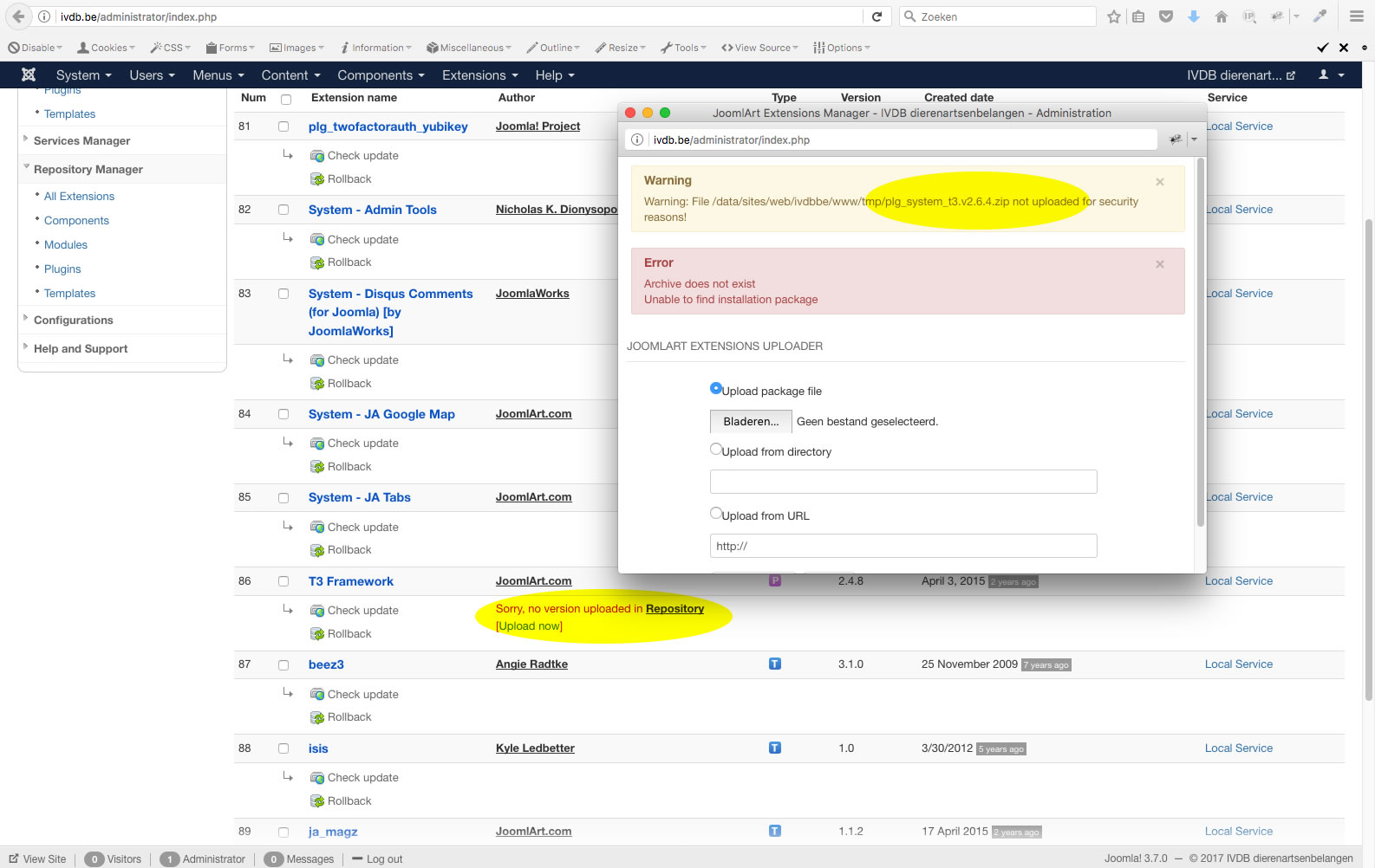

PS: I tried to install the new T3 Framework for 3.7.0 (as the mailing states: "We have updated our T3 framework for Joomla 3.7.0 version. This release fixes all reported issues.") – it also says "Recommended : Use JA Extensions Manager Component for upgrade."
however: JAEM says "Sorry, no version uploaded in Repository"
and when I try to upload the plugin, I get an error message: "Warning: File …/plg_system_t3.v2.6.4.zip not uploaded for security reasons!"
(see attached files)

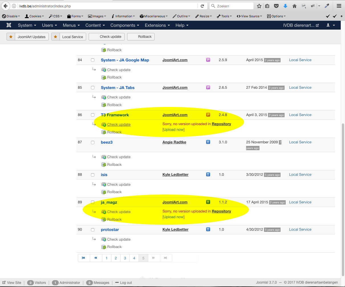

thanks for the feedback.. I tried to update the T3 plugin (to version 2.6.4) but get an error:
- first: in JAEM it says "Sorry, no version uploaded in repository"
- second: (when I tried to upload the plugin): "Warning: File …/plg_system_t3.v2.6.4.zip not uploaded for security reasons!"
(see screenshots attached)
Please advise!
thx in advance,

May 12, 2017 at 8:39 am #1033519In your case you have not got JAEM configured correctly. I can see you are pointing to the local service (on the right) which means the updater is looking locally for the update. You need to point that to the Joomlart repository.
As per above, you can also simply download the file and use the normal Joomla method for updating the plugin.
Documentation on configuring the JAEM is available here – https://www.joomlart.com/documentation/wiki-ja-extension-manager/how-to
May 12, 2017 at 8:50 am #1033522Thanks Phil,
I adjusted the config for JAEM (ok!) and installed the T3 plugin via normal Joomla method. Installation went fine now, however.. it didn’t solve the problem from the homepage articles.
