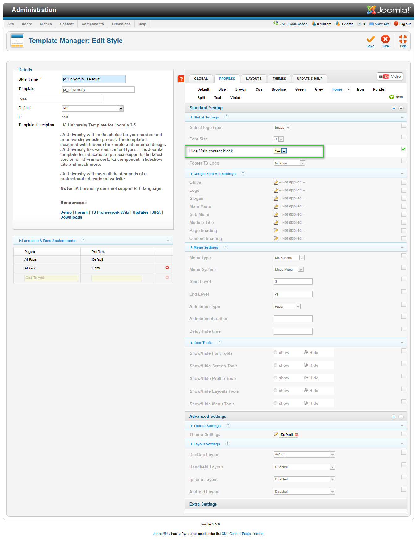

January 3, 2013 at 10:34 am #478256Hello Betorafa,
The page that you said is Homepage, and in JA University, at this page, Main content is set to hide.
To show it, please go to: back-end >> Extensions >> Template Manager >> click to JA University >> On Tab Profiles, click on Profile name ‘Home’ and set Hide Main content block is No. See: http://easycaptures.com/fs/uploaded/503/7463441220.png
Hope this helps.
