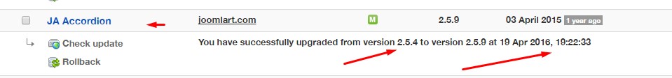

April 19, 2016 at 2:51 pm #919960This reply has been marked as private.pavit Moderator
April 19, 2016 at 5:25 pm #920049Hi @isabelgica
I configured correctly your component and as test i installed an old version of ja_accordion module and as you can see it was updated correctly.
I filled in my Joomlart account info in JA Extension mgr, but still get the error
You should flag it as the default service
