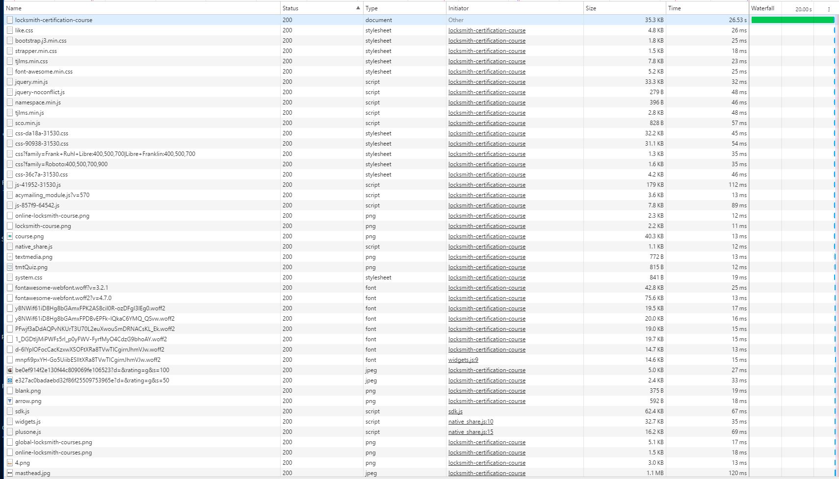

June 26, 2017 at 1:30 pm #1044189That it looks the same is not the issue. The issue is that it takes forever to load when you are NOT logged in. When you are logged in, it takes about 6.51s without optimization. When you are NOT logged in, the same page takes 30.19s to load.
June 27, 2017 at 2:44 am #1044350Hi,
Pls have a look at this screenshot: http://prntscr.com/fokpyc
In the highlighted area, the above part is files from 3rd party extension, it takes time to load these files, below are some compressed css/js files from JA Alumni template.
You can try to inspect in your browser and see the same.
June 27, 2017 at 1:12 pm #1044494I don’t know why you are getting that result, because I am not getting anything similar (see attached screenshot). Regardless, that doesn’t really matter anyway. The issue is that it ONLY HAPPENS with the JA Alumni (or maybe T3 template) template when NOT LOGGED IN. Whenever you try any other third party template everything works just fine.
