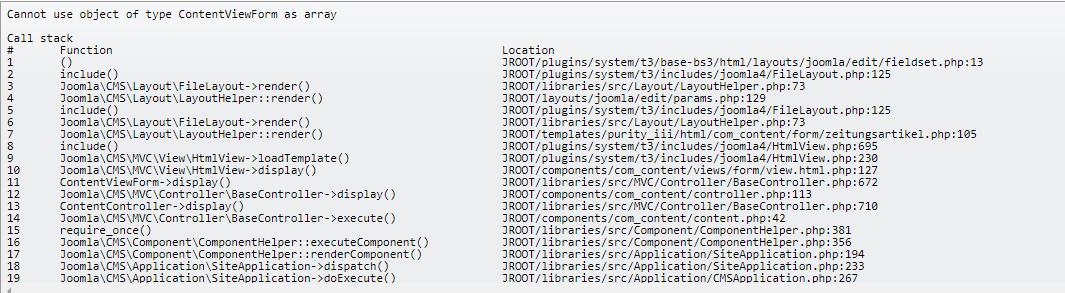

Hello experts,
I made an override of com_content/vies/form/tmpl/edit.php by copying the edit.php and edit.xml to html/com:content/form folder in the templatefolder of my purityiii installation.
I only copied and renamed these two files and changed the xml to gt a new menuentry option.
When I open this override the site isn’t shown correctly and I get an error > 0 – Cannot use object of type ContentViewForm as array
I allready tried the sollution found at https://www.joomlart.com/forums/topic/bug-found-in-t3-2-6-5/
but it has no effect to me.I know it has something to do with the call > JLayoutHelper::render(‘joomla.edit.params’, $this);
When I delete the joomla. from joomla.edit.params the site is shown correctly with no error, but all cutom fields are missing.
Please help me.
regards,

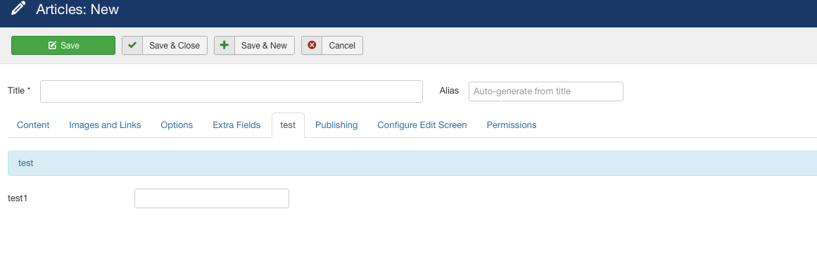

December 25, 2017 at 2:58 am #1083102Hi.
You don’t have to override to show joomla custome field.
It’s already exists.See my screenshot.
I renamed t3/layout edit folder.
December 27, 2017 at 6:37 am #1083344which folder did you rename?
December 27, 2017 at 7:11 am #1083347This folder: /plugins/system/t3/base-bs3/html/layouts/joomla/edit_
