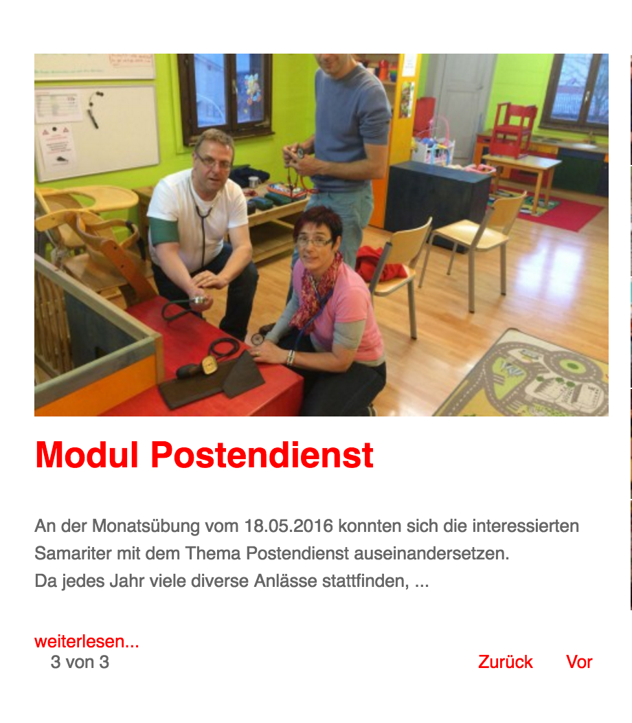

    I enabled News module (JA News Featured) see the video here and I could not see the problem on your site.
