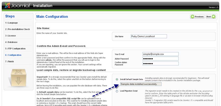

Did you click on the install demo content on the last page of installation of quickstart? Also which template quickstart did you try?

September 21, 2010 at 5:35 am #356208<blockquote>its for installing quickstart on localhost… but the basics are same..</blockquote>
I said above, the basics are same. You unzip in folder and call the folder from the frontend to start the online joomla installation.
<blockquote>
– I extracted all files in the Quickstart and uploaded the files I could see in Quickstart via ftp over the original Joomla! install. </blockquote>That is wrong.
Now read the below lines carefully.
1. Quickstart is nothing but joomla with added demo content.
2. If you know how to install joomla on a webserver (Not using fantastico script). You can install quickstart the same way.
3. Overwriting its files over a already installed joomla is not going to work. Not sure, who told you to do that.
4. 90% of demo content is in the database. So, a complete fresh installation is must if you want to use it. The remaining 10% of demo content are images, which are also installed in correct folders if you perform the installation.So, install quickstart as you would install joomla.

October 22, 2010 at 8:18 pm #360161Yes, if you uploaded the files to your hostings root then just browse to the url. If you uploaded to a subfolder then browse to that. Then follow through the installer as you would any normal Joomla install not forgetting to press the “Install sample data” button near the end. Make sure you have all your mysql database details to hand before you start.
