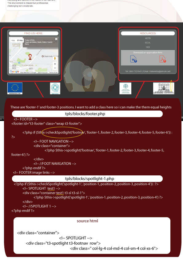

I am trying to customise layout of content within the spotlight-1.php file.
I have my page set to display 3 footer items and can see in footer.php that ‘spotlight’ is loaded. When i look in that file i can’t see any options for configuring how the different cols are displayed on different sized devices.
When i check the code in ‘firebug’ i can see that this info is automatically output eg footer-1 ‘col-lg-4 col-md-4 col-sm-4 col-xs-6’ but footer-3 outputs ‘col-xs-12’. I don’t want this column to be set at col-xs-12.

March 29, 2017 at 9:50 am #1022895Thanks Pankaj, Yes i’m aware of whats possible through the template manager. What i want is to be able to edit the code that is output. I can access all other areas of my template eg header.php, one-sidebar-left and footer.php. I have set my template to show footer-1,2 and 3. However i want to edit the col classes eg add a class,change the layout for responsive design(footer-3 automatically goes to col-xs-12 while 1 + 2 go to col-xs-6 – I don’t want this. I also want to set an equal height class for these columns on larger devices. I can see in footer.php spotlight is called ‘<?php $this->spotlight(‘footnav’, ‘footer-1, footer-2, footer-3,….’ but in the spotlight-1.php if i add a class eg ‘testing’ [code][code] <div class="container t3-sl t3-sl-2 testing"> its not showing in the source. What shows is [code][code] <div class="t3-spotlight t3-footnav row"> Basically i am looking for a file ‘spotlight.php (presumably) as ” is showing ‘SPOTLIGHT'( not SPOTLIGHT-1) in the source code comments. The only files i see are spotlight-1 and -2. Hope i’m not being too vague!

Am aware of editing files in /tpls/blocks but can’t get into how this particular block of code is executed. I have 3 footer positions enabled and can’t see if its spotlight-1.php or spotlight-2.php is called.
As i was looking in etc/layout/ files i couldn’t see where any xs columns were being output as ‘col-xs-12’. I have just discovered that the file i was looking for was in local/etc/layout/ so can now edit width of column on responsive screens.
The only thing i’d like to figure out now is how to add a class to this line of code. I can do it in any other part of the template but not here. I have added test classes to eg div class="container t3-sl t3-sl-2 test" on spotlight-1.php or spotlight-2.php and added comments but they don’t show on executed code

April 3, 2017 at 10:25 am #1024247Thanks.
Still can’t figure out how to add a class to the spotlight area. I can do it in any other part of the template but not here. I have added test classes to eg div class="container t3-sl t3-sl-2 test" on spotlight-1.php or spotlight-2.php and added comments but they don’t show on executed code
I know all the positions files are here… /tpls/blocks. I can access all areas of my template here but not ‘spotlight’?

Kindly post screenshot of the issue and illustrate the issue inside the screenshot, also post site URL here.April 4, 2017 at 11:02 am #1024531The only spotlight files i have in tpls blocks are spotlight-1 and spotlight-2(i don’t know which file is called) If i add a class like eg ‘test’ , it doesent show in the source code. Also if i add a comment ‘test’ – it doesent show. I notice that in each file the comment begins with ‘SPOTLIGHT-1 or SPOTLIGHT-2’ whereas in the output code the comment is SPOTLIGHT ( I DON’T UNDERSTAND WHERE THIS CODE COMES FROM AND HOW I CAN ACCESS IT SO I CAN ADD A CLASS TO MAKE THE COLUMNS EQUAL HEIGHT

RegardsApril 4, 2017 at 12:58 pm #1024546so, where do i add a class that will be output in this line
<!-- SPOTLIGHT --> <div class="t3-spotlight t3-footnav row">?

April 5, 2017 at 2:58 am #1024632Kindly share the site URL, i will help you to apply the code.
Also you can apply the code on t3-footnav class.
