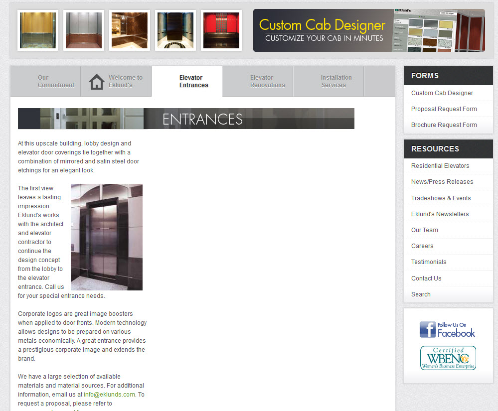

March 6, 2018 at 5:51 pm #1095602So I just purchased the Extensions membership and I was able to get everything rebuild from scratch except the JA Tabs. In 1.5 I could make a module with JA Tabs. How do I work with it now that’s its a system extension? I found some code in my template documentation for portfolio and added it to a custom module. However, it’s completely broken. I see some of my 1.5 copy in the tabs. But nothing is right. How do I work with the new JA Tabs. Thanks.
March 6, 2018 at 10:18 pm #1095628Update….. So I found the JA Tabs Document. I’m down to just three problems I can’t seem to figure out.
- Why is all the content (Not Tabs) 260px wide. I’ve gone round and round adding the width code to zero effect.
Seems to be coming from here:
.ja-tabswrap div.k2ItemsBlock .moduleItemIntrotext {
width: 260px;
} - My icons are now missing from the tabs? Not sue where to find them or add/change them.
- Have an extra tab i don’t need. "Welcome" tab. Can’t figure out where to turn it off.
I’m currently in a custom module using this code:
{jatabs type="modules" module="tabs" position="top" mouseType="hover"} {/jatabs}I will be set if I can figure these thing out.
Thanks,
Keith
