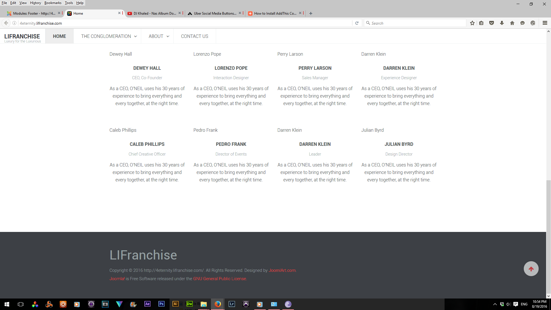

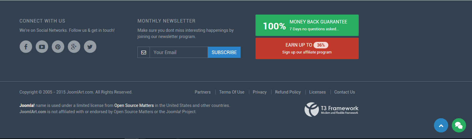

I am trying to adjust the footer to look like the joomlart footer however I have no social media footer options with my Uber Template, any suggestions

August 23, 2016 at 2:36 am #962205Hi
as i suggested in your other posts to make a site like Joomlart site , you have to make personal custom work .JA site is not using JA uber , if your question is on the JA Uber you can add acm footer module on your site
with help of this doc
You only need to create ACM modules as in doc to get the same module like in JA Uber .For making a site like Joomlart.com , you can use custom icons from font awesome and style them like on Joomlart . To check the style code use inspect element or firebug from the browser and then override them in custom.css file .

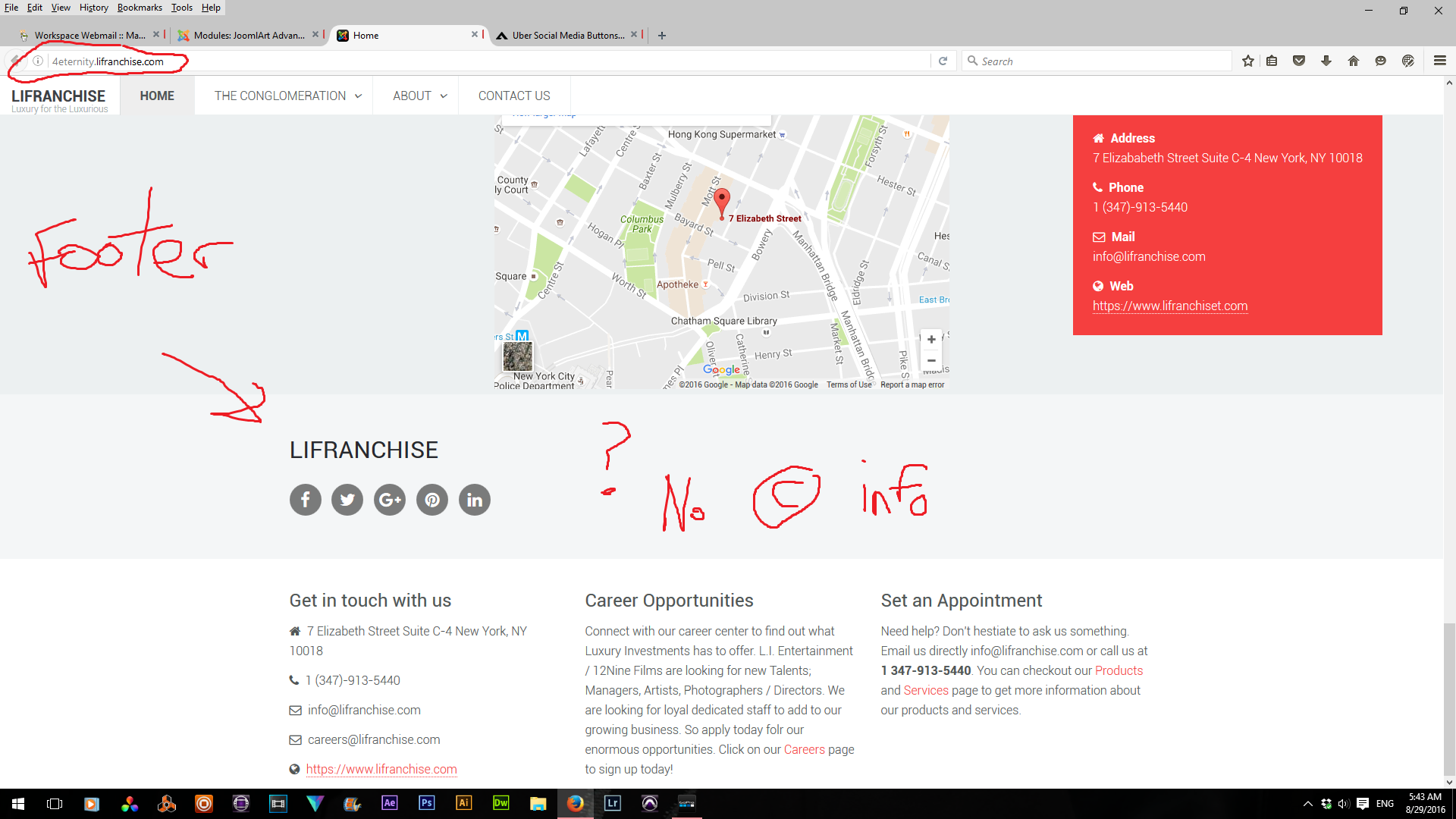

At present there is nothing in your footer that can be removed : http://prntscr.com/c9n9irAugust 29, 2016 at 9:46 am #963729As I said before, the site is not studios That site we scratched because of all the bugs on it, the current site we are test running is https://4eternity.lifranchise.com and the information for you to log in is above. Currently we have footer content however the copyright information is missing. I want to know how to edit the copyright information and enable it, the log in information was previously given, can you please access 4eternity.lifranchise.com and figure out whats going on?
August 30, 2016 at 1:50 am #964056Hi
Copyrights info comes from the Joomla footer module : http://prntscr.com/cbwyza
I published it on your site .
And the social media icons are coming from your Footer main module : http://prntscr.com/cbwzrx
Open module and edit them .To edit copyrights :
Go to /html/mod_footer/default.php" in template "uber"
And /language/en-GB/en-GB.mod_footer.ini

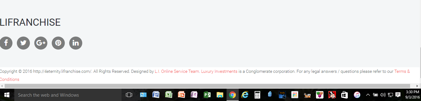

Here is documentation to chnage copyrights info .September 3, 2016 at 7:35 pm #965354it finally says what i want it to say, now I need to make it look the way I want it to look. I chose the Light Background Footer on the Template options that you showed me earlier, however it is not looking how its supposed to, can you access it and make it have the Subscribe Portion as well as the Icons. Its currently made under FooterJCM however the footer looks completely different. Attached is what it looks like and the other file is what it should look like. Thanks again Also if you look at the LIFranchise portion where the buttons are, its missing the copyright information, I would like it all to be in that content block, thank you for your help again.
September 5, 2016 at 3:17 am #965602Hi
I setup again the footer part on your site > http://prntscr.com/ce8jqn
You can see the social icon in footer , For the Acymailing , you have ato install Acy mailing component and then published Acy mailing module on acymailing position .Module position: acymailing
Module Suffix: NOT USED
Find detail setting hereAlso i request you to open a separate thread for new questions , the Topic question was already answered .

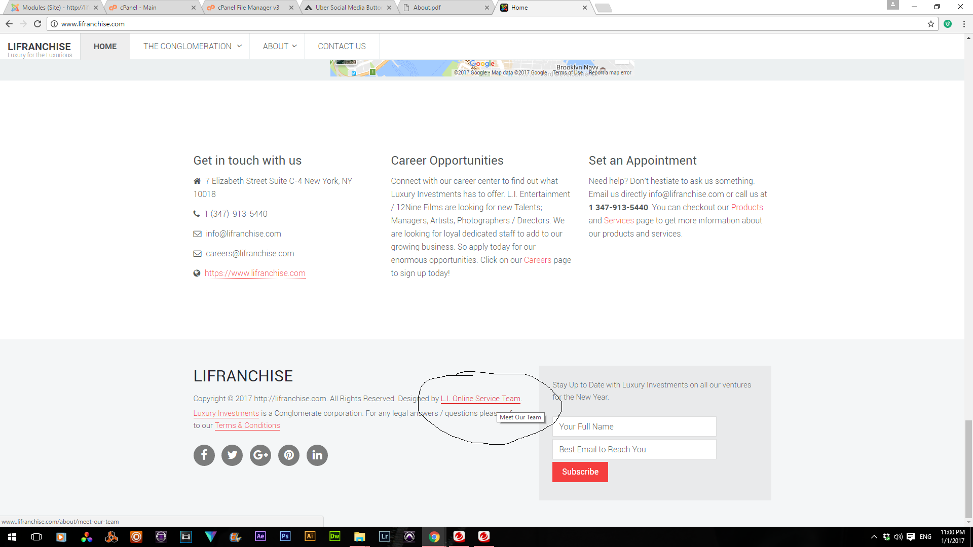

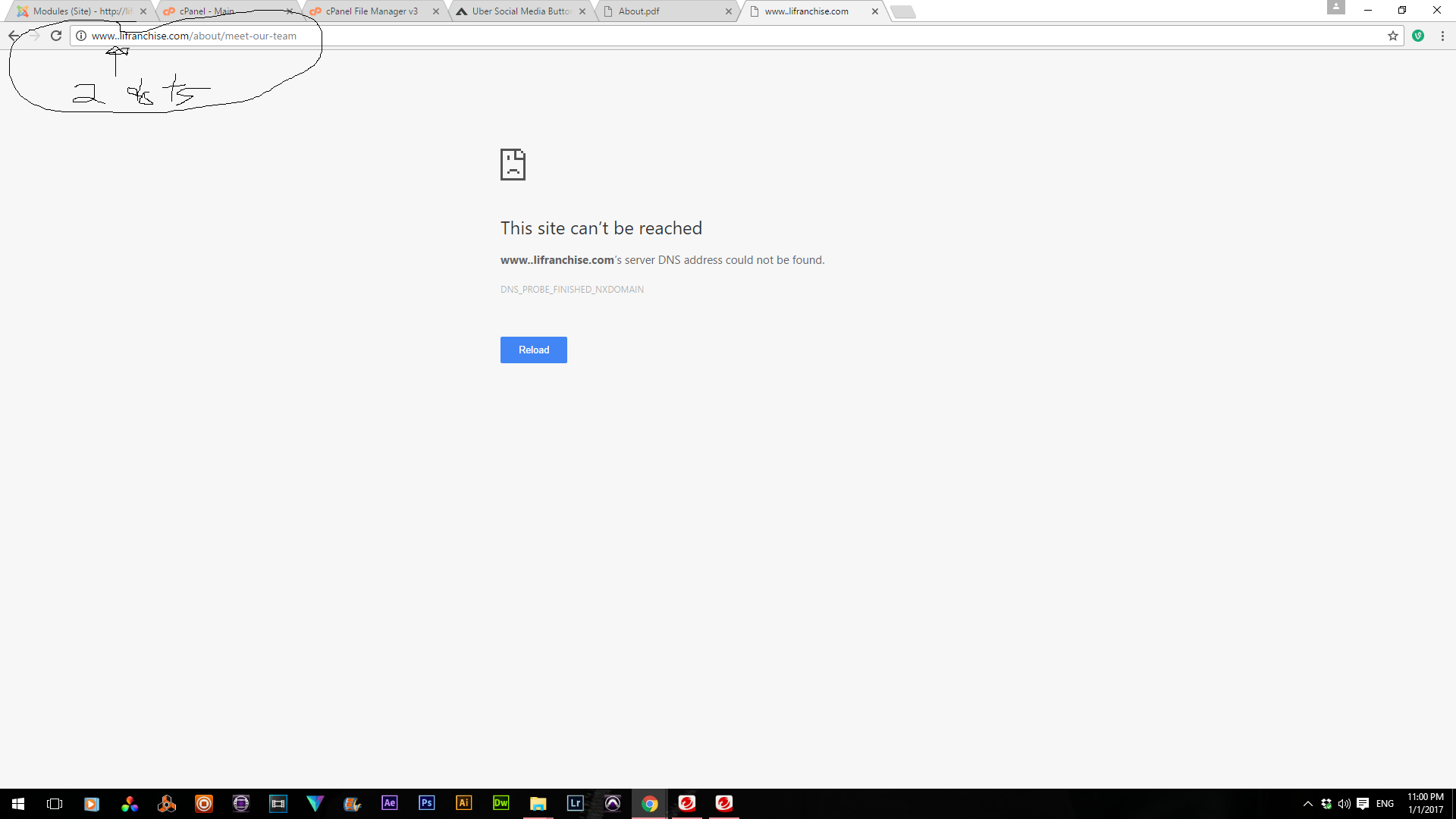

Sorry to have to bother you again but I have another situation with the footer. As you can see I changed the information on the footer but the external link that it is supposed to go to ends up having 2 .s on it. so the link should be: http://www.lifranchise.com/about/meet-our-team
its turning to this instead: http://www..lifranchise.com/about/meet-our-team please help I have no idea where to find the file / php to change the information, just so you know I went to the mod_footer.ini file and changed the information but the "Copyright Ā© 2017 http://lifranchise.com. All Rights Reserved. Designed by L.I. Online Service Team." part is missing and I can not for the life of me find it. Please help. Thank you kindly and happy new year.
