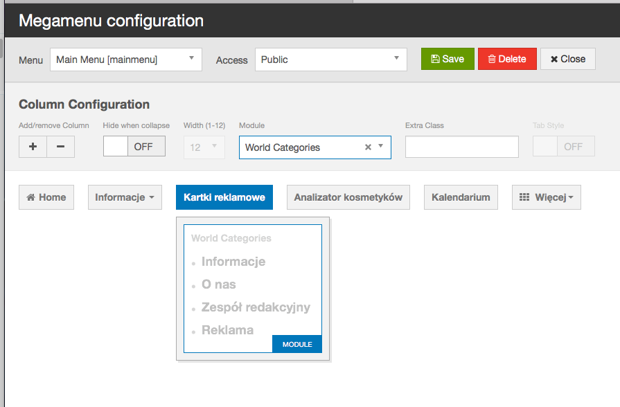

There is a problem that I can not eliminate in any way and I can not understand what its source is. To show it, I recorded a video. In short, when I try to add a module to a Megamenu item, I get a message:
This module might not available with current Access Level
Please take a look at the video, I need help to solve that.

January 12, 2018 at 4:20 am #1086437Hi,
It’s not T3’s bug. It’s because the "World Categories" module does not have any content to show.
if the module has content you will add successfully.
January 12, 2018 at 11:58 am #1086511Thank you for your help. Now I can work with the site, without the message "This module may not be available with current Access Level"
