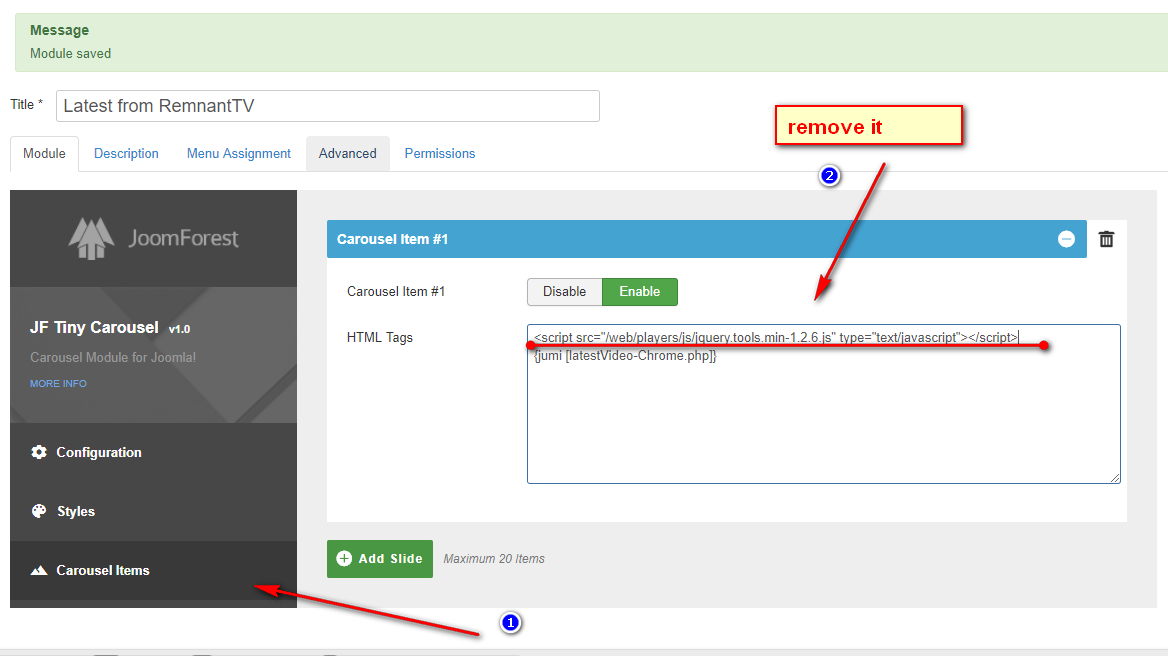

March 2, 2018 at 9:15 am #1094854Hi,
It due to another 3rd party extension on your site: mod_jf_tinycarousel which loads additional jQuery and cause the conflict.
The search button in filter module should work now: https://remnantnewspaper.com/web/index.php/headline-news-articles
Kindly check.
