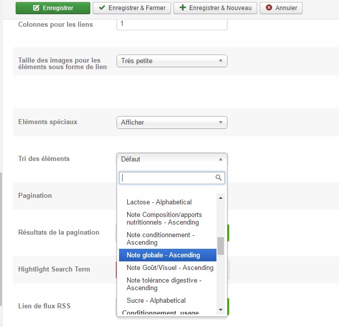

    I choose Numeric type for my extra field in Ja k2 filter config, I cant’t choose ascending or descending mode here.
    When I want to config it in Jak2 filter menu link (type items list), I can’t choose "Descending" mode. I attached a screen capture.
    Thank you

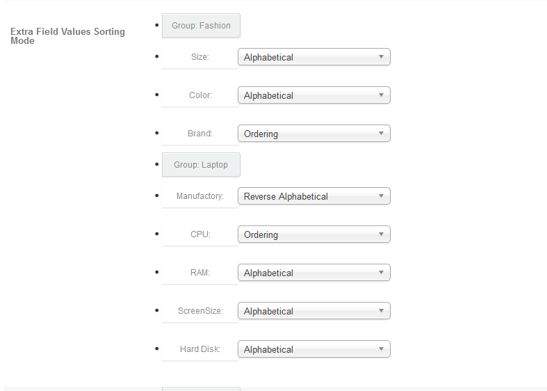

    Did you see part "Extra Field Values Sorting Mode"? each Extra Field has three options: Ordering, Alphabetical, Reverse Alphabetical. I have uploaded attachment so you can have a look.
    Ordering : all values of Extra Field will sort by the order you set in K2 >> Extra Field. Alphabetical: all values will order from 0-9 (if you set value type is Numberic), or a-z (if you set value type is String) Reverse Alphabetical: all value will order from 9-0 (if you set value type is Numberic), or z-a (if you set value type is String)
    The sorting function doesn’t support for K2 Extra Field type Text Field.

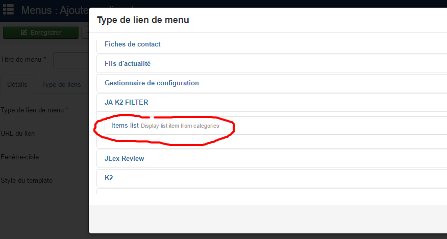

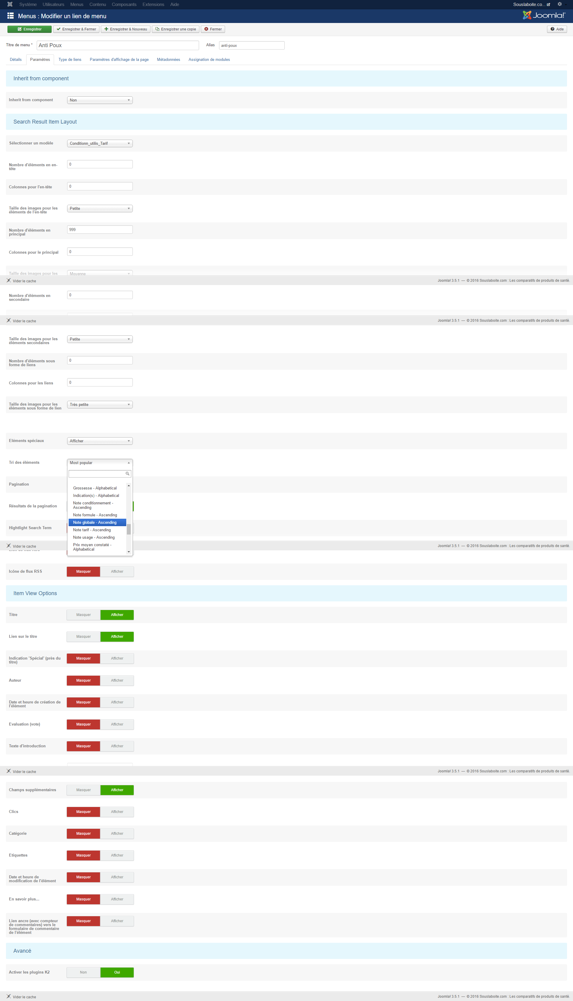

    Yes, I saw it and everything is like you said. I’m not sure we we are well understood… My problem is with the menu link type "JaK2 filter-> Itemlist" (attached file : capture item list menu.png). I can’t order descending (attached file : ordering menu link layout.jpg) : "MyExtraField – descending" doesn’t exist. Is there a problem ? Is it normal ? Thank you.

    I get your question.
    Since we have Multi Order, so the Descending was removed in latest version.
    To revert it back, use the file I attached here, and overwrite in
    administrator\components\com_jak2filter\elements\k2orderfield.php
    1. k2orderfield.zip
