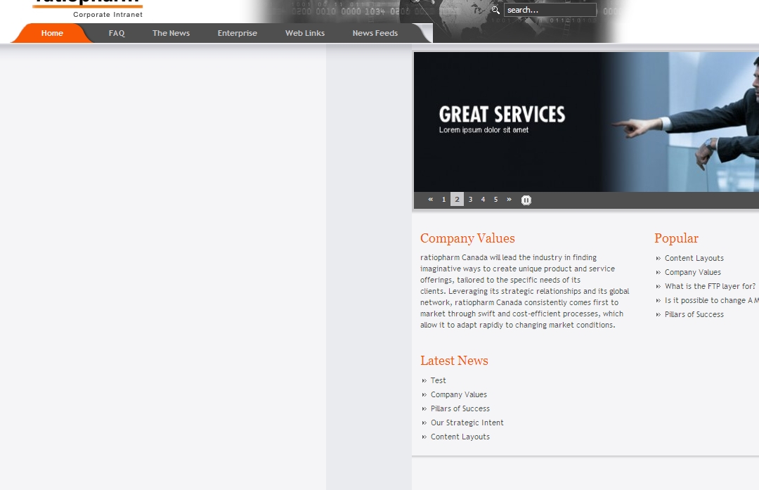

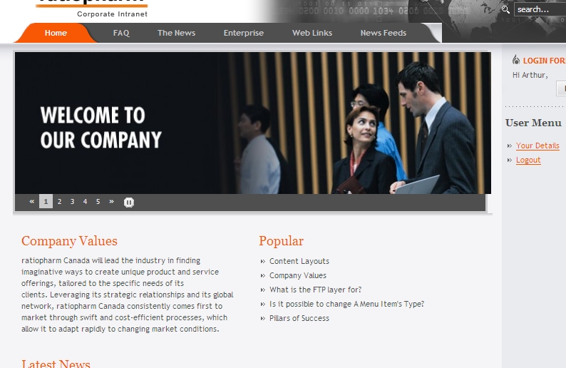

Trying to use the slideshow module on the front page and it renders properly in FF but it is out of whack in IE7. When I refresh the page in IE, the first image in the series is positioned just as it should be, then as soon as the next image in the series is displayed, the screen shifts to the right and the image temporarily repositions to the left (overlaying the menu) then it goes back to the slideshow container, but the page is still shifted to the right.
I can’t give you a link as it is an internal site, but here are some snapshots (see the attachments.)
