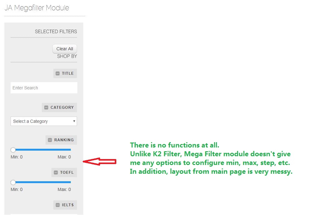

Hi, I tested your Megafilter briefly… it returns correct results. However, there are a couple of issues:
1) Search results only display "View Details" buttons, no article titles, just like your demo.
2) Module is tied to a menu (it requires a menu to set up the module). So when I click the menu, I will have duplicate search forms:one is search module, another one is from menu. Both are exactly the same search forms, which makes web page display redundant.
By the way, I use your filter only for out-of-box Joomla articles, nothing else.
I just removed it from my website, but I think you know what I am talking about. I post this topic to see if it’s possible to fix it. if not, I may want to switch back to K2 Filter. But the problem is that K2 Filter doesn’t return correct results based on my previous test.

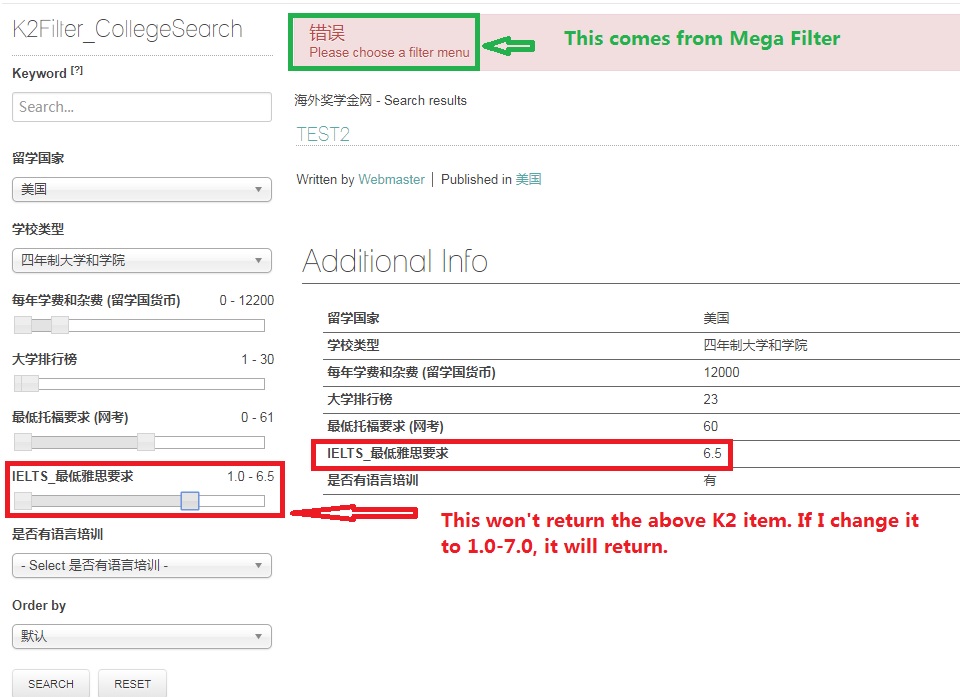

December 19, 2017 at 3:46 pm #1082214I have tested and compared both Filters, and decided to use K2 Filter instead. Please activate my K2 Filter license and deactivate Mega Filter license.
But I do need get K2 Filter fixed on the issue below. (see attachment Decimals_not_working.jpg )
K2 Filter generally works fine, but slider doesn’t return correct results on decimals. If it’s a whole number, there is no problem. If it’s a decimal, it won’t work.
For data and module testing, go to this page: http://overseascholarships.com/index.php/colleges
Module Name is: K2Filter_CollegeSearch
Problematic K2 Field: IELTS_最低雅思要求 (alias: ielts)The problem for decimals on this slider is:
It returns only larger than (>), not larger equal than (>=).-
