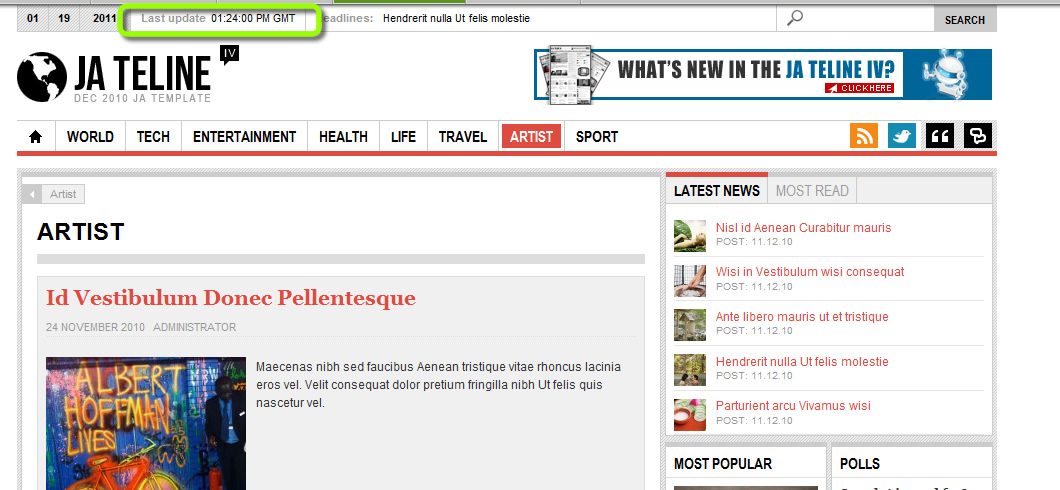

January 19, 2011 at 9:16 am #372630In order to find a quck bug fix for this static time problem, I just wanted to inform that on the Joomlart demo site for Teline IV one can see the same error … I think.
Have a look at the green area in the attached image.
– Joomlart’s demo website is showing 01:24:00
– My static time on my website using Teline IV is showing 12:24:00

January 19, 2011 at 2:04 pm #372682<em>@christofferl 216034 wrote:</em><blockquote>In order to find a quck bug fix for this static time problem, I just wanted to inform that on the Joomlart demo site for Teline IV one can see the same error … I think.
– My static time on my website using Teline IV is showing 12:24:00</blockquote>I think the time varies server to server as well as your joomla time settings.
