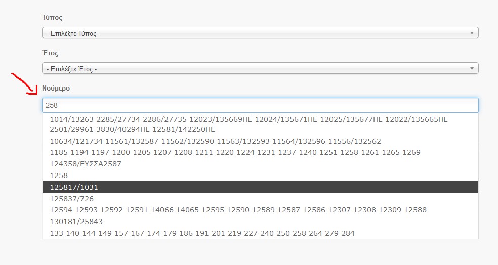

i have an extra field that we put numbers with "/" (slash).
Unfortunately the result is null with the slash.
Is there any way for the slash to be searchable?

Please have a look at the screenshot. When i choose numbers with a slash i get no results. If i choose only number everything is ok.
Thanks!

August 25, 2016 at 9:28 am #962955Please have a look at the screenshot. When i choose numbers with a slash i get no results. If i choose only number everything is ok.
We see the problem now, I have reported to the developer this issue. We’ll reply to you right after we have the solution.
