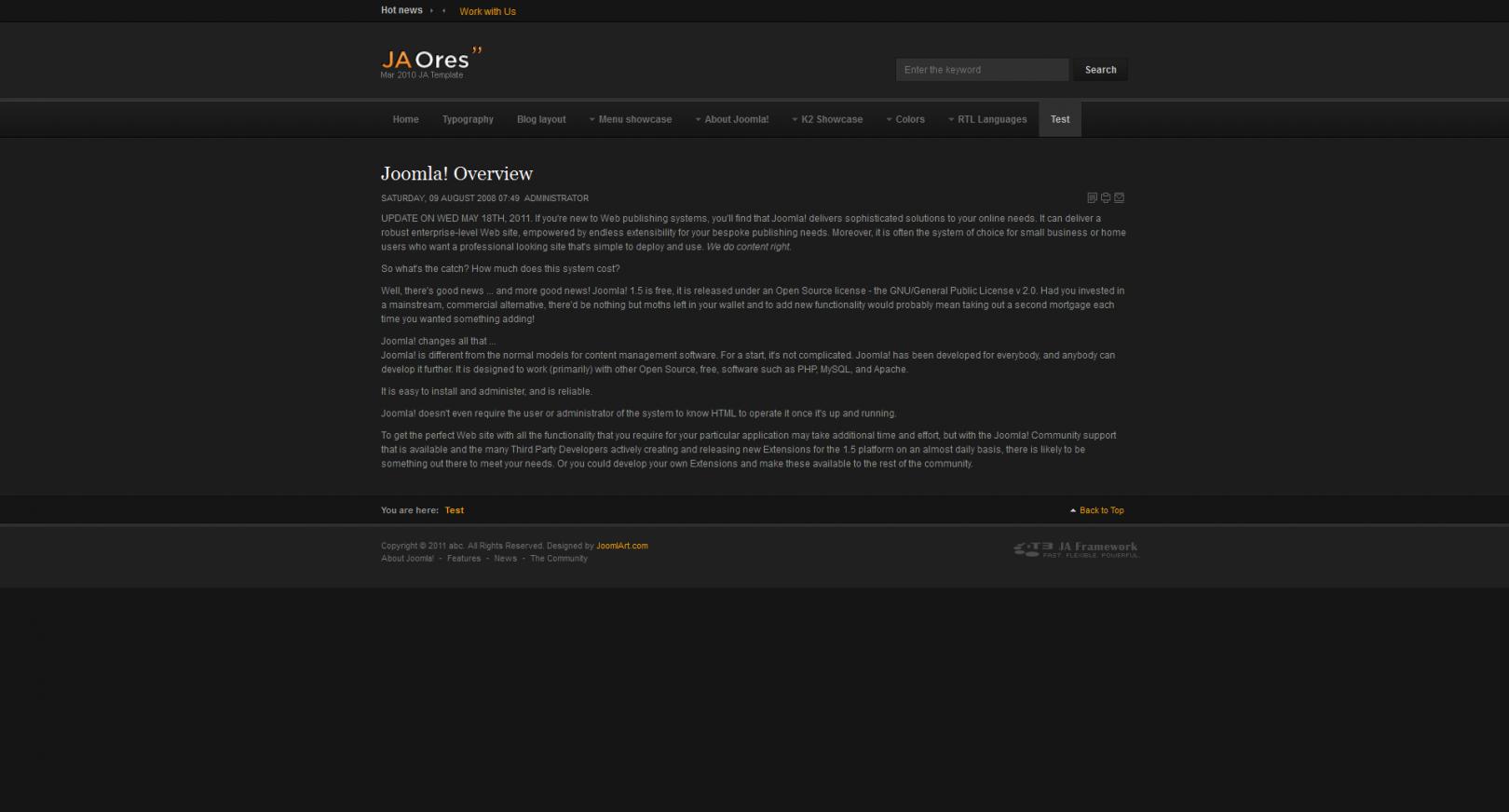

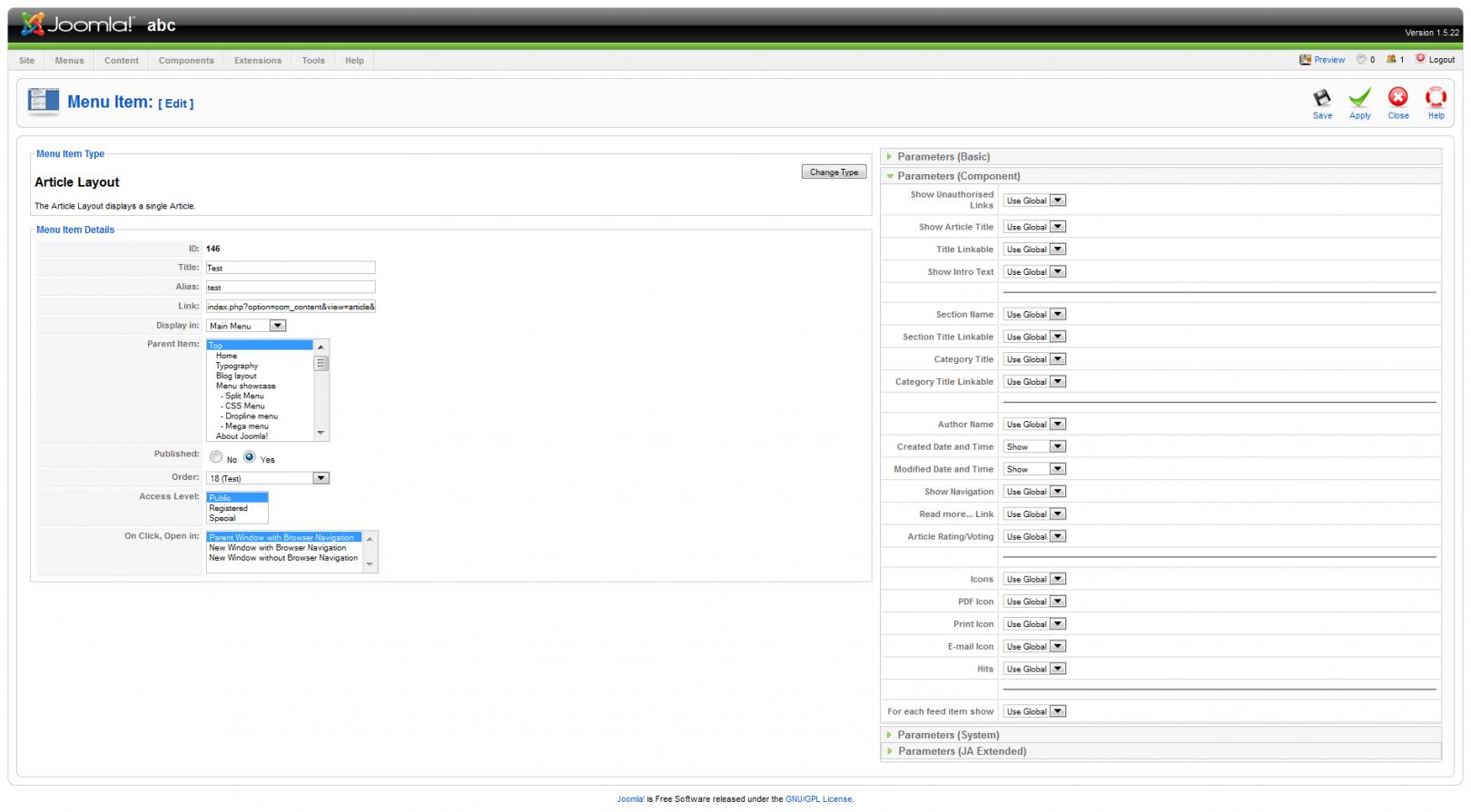

Ok…i will take screenshots instead. please wait a momentMay 19, 2011 at 8:22 am #391929Here are they:
– screenshot1.jpg: the article shows but does not have “last update” field information
– screenshot2_menu.jpg: parameters that i setup for menu
– screenshot3_article.jpg: parameters that i setup for the articleYou could reproduce this issue easily by installing quickstart and try to configure to show last update field for articles only
