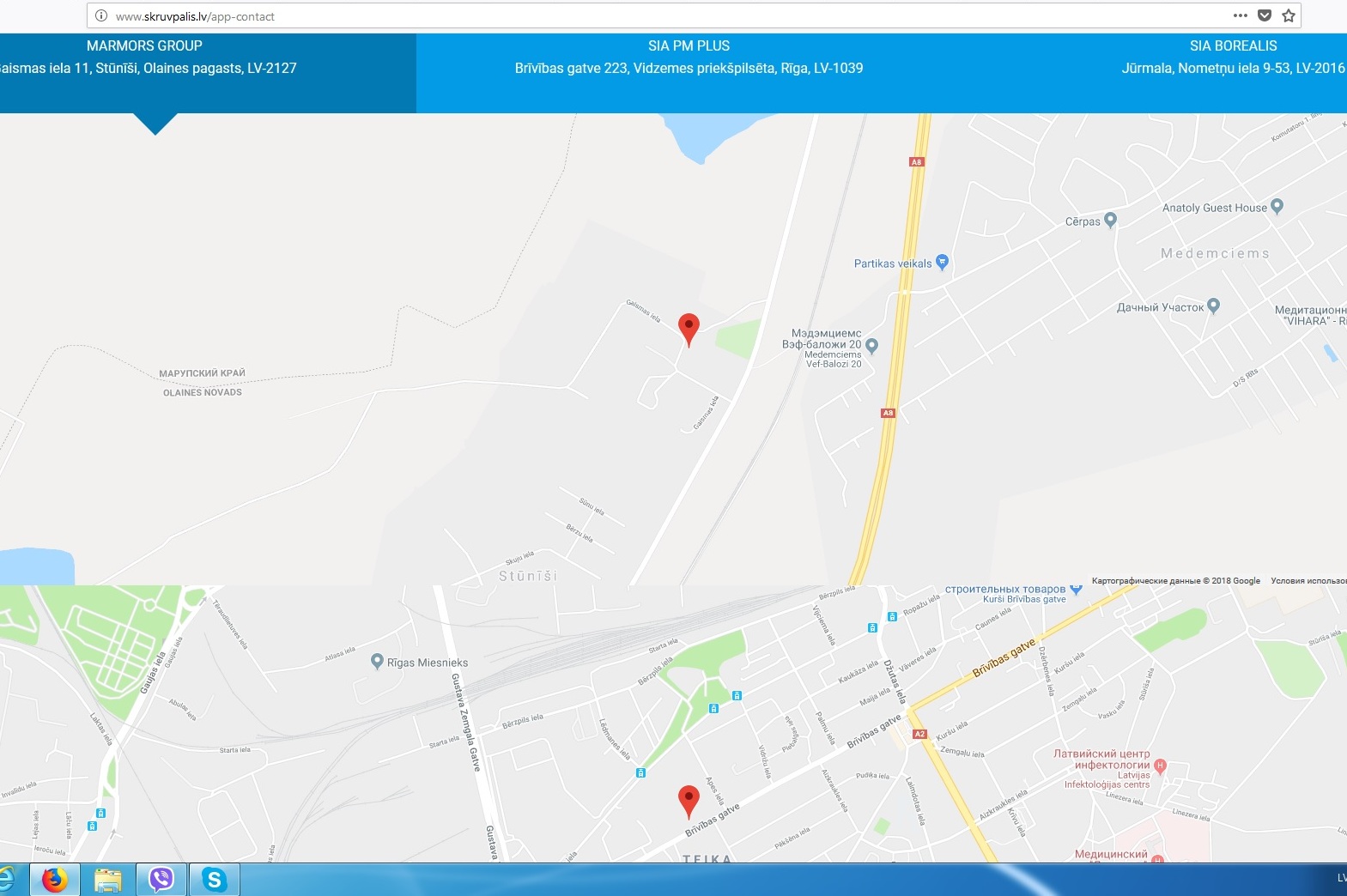

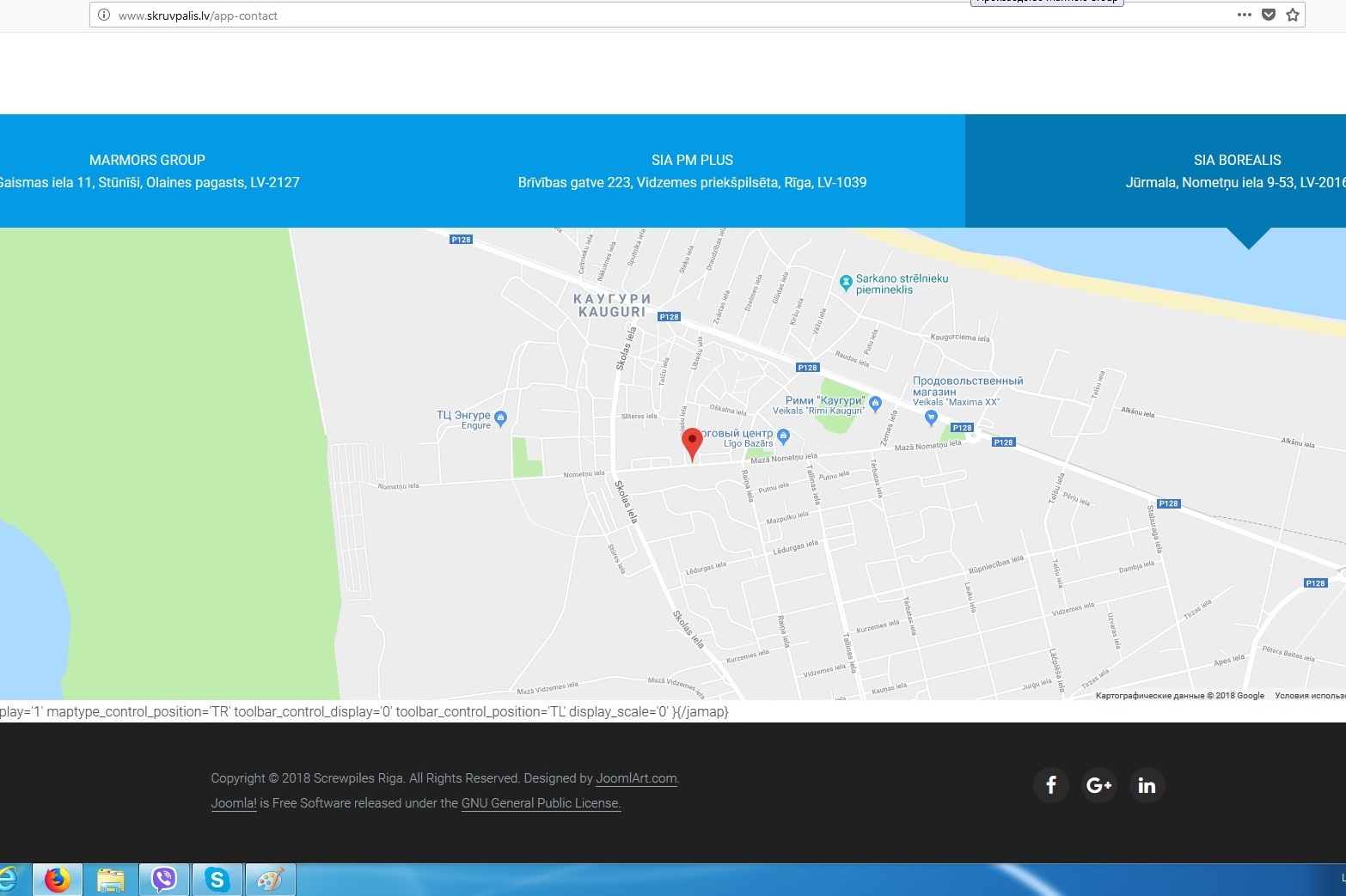

    Hello!
    I have used TAB ACM module for dipslaying map for 3 addresses. Unfortunately, when clicking on Contact first tab is displaying 2 maps at once, one below other, and the 3rd tab has a code line below the map: maptype_control_display=’1′ maptype_control_position=’TR’ toolbar_control_display=’0′ toolbar_control_position=’TL’ display_scale=’0′ }{/jamap}

    Unfortunately, no. Same problem here. Both, in Firefox and Chrome.

    There is something wrong here, I’ll share with the dev crew for further checking & update.

    I updated this file: /acm/tabs/tmpl/style-2.php
    <!-- Tab panes -->
    <div class="tab-content">
    <?php for ($i=0; $i < $count; $i++) : ?>
    <div class="tab-pane <?php if($i<1) echo "active" ;?>" id="tab-style2-<?php echo $i ; ?>">
    <?php echo $helper->get('map', $i) ; ?>
    </div>
    <?php endfor ; ?>
    </div>
    For the plain of code show under the map, it due to the wrong code (not sure how you have it), I updated for you and it’s showing fine now.

    I am not sure how I got the wrong code, as I did not do any coding for this site yet… Thank You very much for the help, it is smoothly working now 🙂
