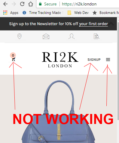

March 29, 2018 at 1:38 pm #1112997Hi there,
That’s great I can now click the logo and it links OK!
Another major problem has cropped up though, which is I can no longer click my ‘burger (side) menu’ icon and my other links on the mobile view (in that area) no longer work either.
Please see attachment for the links and icons that don’t work.
PS: I’ve had to remove the code above so that my menu still works…but when you come to have a look at the issue you will need to add in the custom.css code back in:
@media (max-width: 767px) { body.header-horizontal .logo { /* height: 1px!important; */ position: absolute; width: 95%; z-index: 101; }

- 5345 times in 4963 posts
April 2, 2018 at 10:58 am #1113267Did you get it solved? as I can see these buttons/text are still clickable.

April 2, 2018 at 11:11 am #1113270Hi,
No its was only working due the code above was not in the custom.css file…But I have now added it back on again…and the icons and links next to the logo no longer work.
Please advice

April 3, 2018 at 10:19 pm #1113325Hi there,
I’ve had to remove the code again (that makes the logo clickable when the positioned next to my menu icon’s etc)
As I need the menu to still work on mobile whilst trying to fix this issue.…but when you come to have a look at the issue you will need to add in the custom code back in to the custom.css to see the problem.
