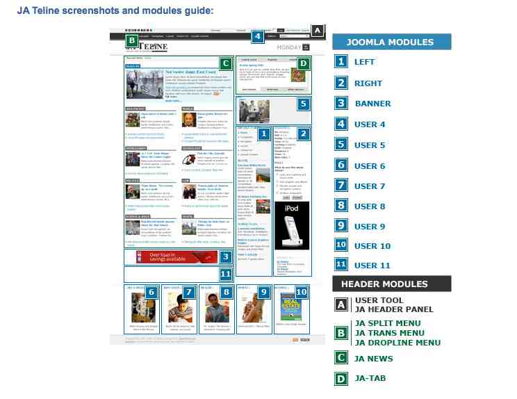

ChrisNovember 1, 2008 at 10:13 am #277695If you look at the attached chart of module positions, the place where I want the video to go–the upper right hand corner–is labeled “D”–JA-TAB
But this is not one of the choices in the pop-up menu of the module menu.
Can anyone clarify this?

November 1, 2008 at 4:17 pm #277710Thanks everybody. Those are all good suggestions. Backing up is something I planned to get to, but since this is a new site I hadn’t gotten around to it.
I did disable all the modules on the right side columns, but the results are puzzling. When I restore Latest Video to User 5 position, it shows up in the correct place on the News page, but stubbornly sticks beneath the banner on the bottom of the Home page! Since it’s the same width for both, I don’t understand this behavior.
Where would I look for the differences in the coding on the two pages? Is this a css or html thing?
