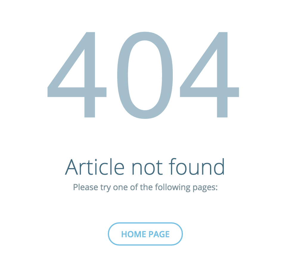

June 3, 2015 at 11:46 am #572720<em>@andrewwinkler 476145 wrote:</em><blockquote>There are many posts with code in that thread. Do you mind add the correct one to this thread to save us the trouble of guessing (and trial&error) the correct one? Thank you.</blockquote>
I made the 404 error page you can get it and follow the steps below
+ Download and extract my attached file
+ Copy error.css file into templates/ja_teline_v/css/ folder and error.php file into templates/ja_teline_v/ folder
and you should get results as shown in the screenshot below
