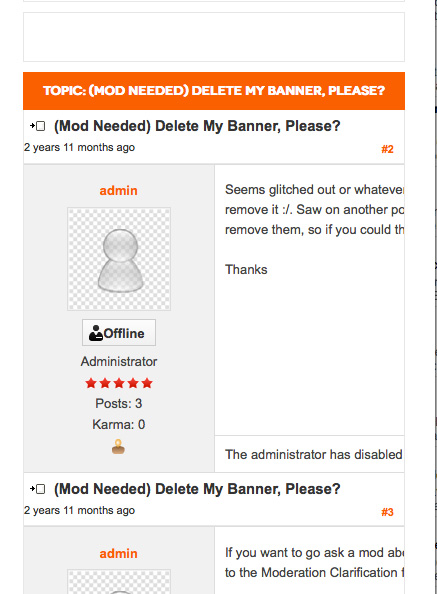

January 18, 2016 at 3:58 pm #851837Hi, I just installed the JA Mitius template and I’m using the Kunena Forum and its JA Template.
The thing is that it is not fully responsive!!!
I’m really surprised with this…
Please take a look to the attached file.
Is there any issue for this?
(Im’ Using mitius template for kunena)pavit Moderator

January 18, 2016 at 5:01 pm #851877Why you install it and it works and I install it and it doesnt work?
I have the attached file, like you see, it is not responsive when I create a post.My settings are OK, it is not about settings, it seems to be something from the css code or something is not working on the responsive mode.

January 18, 2016 at 5:44 pm #851929Hi,
Yes I saw the kunena configuration in the link you gave me, I say again: there is nothing that helps me.
Thanks for the link you gave form the JA Mitius demo, it shows that the kunena JA Template is not responsive, plase take a look to the attached file I’m sending you
Could you please help me to figure out?

January 19, 2016 at 6:37 am #852446Hi there
Please open this file /templates/ja_mitius/css/custom.css and add these code
@media (max-width:579px) { #Kunena div.kmsgbody div.kmsgtext { padding-right: 25px; margin-bottom: 40px !important; } #Kunena td.kmessage-left {overflow: hidden; padding: 10px 10px 0;vertical-align: top!important; width: 100%; display:block; } #Kunena td.kprofile-left { overflow: hidden; padding: 10px 10px 0 10px; width: 100%!important; display: block; max-width: 100%; } #Kunena table, #Kunena tbody { display: block; width: 100% !important; padding: 0; } #Kunena table tr { display: block; width: 100%; } #Kunena div.kmessage-buttons-row { white-space: normal; padding-right: 10px; } #Kunena .kblock div.kheader, body #Kunena div.kblock>div.kheader h2{ white-space: normal; padding-right: 0px!important; } }Let me know if this solve your issue
Best regards

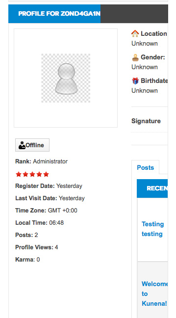

January 19, 2016 at 6:53 am #852451Hi Pavit, Thanks for your help. The code you gave me it is working right. All is OK in the posts. But I still have a little problem in the profile section, please take a look to the attached file. Thanks a lot again.
January 19, 2016 at 10:01 am #852876Hi there
Same problem as previous , i passed your info to developer team , as soon they will have a look at it i will post solution here
