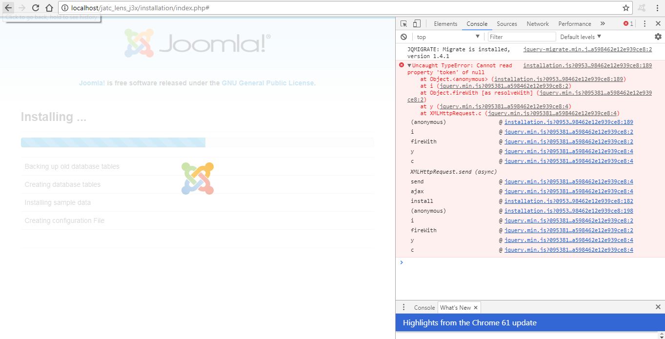

October 9, 2017 at 9:15 am #1066755I have already built a Joomla 3.7.4 website with Joomla package and JA Decor template. It is working fine. Problem is only with the quick start package of JA Lens.
All system requirements are met.
October 9, 2017 at 10:30 am #1066764Kindly check on the step which hangs, use Inspect Element on the browser > console tab and see if there is any error there.

October 10, 2017 at 3:09 am #1066918This reply has been marked as private.October 10, 2017 at 12:24 pm #1067018I have fixed the issue. Googled the resolution steps.
Updated the "max_execution_time" parameter in php.ini from 30 to 90 seconds.
