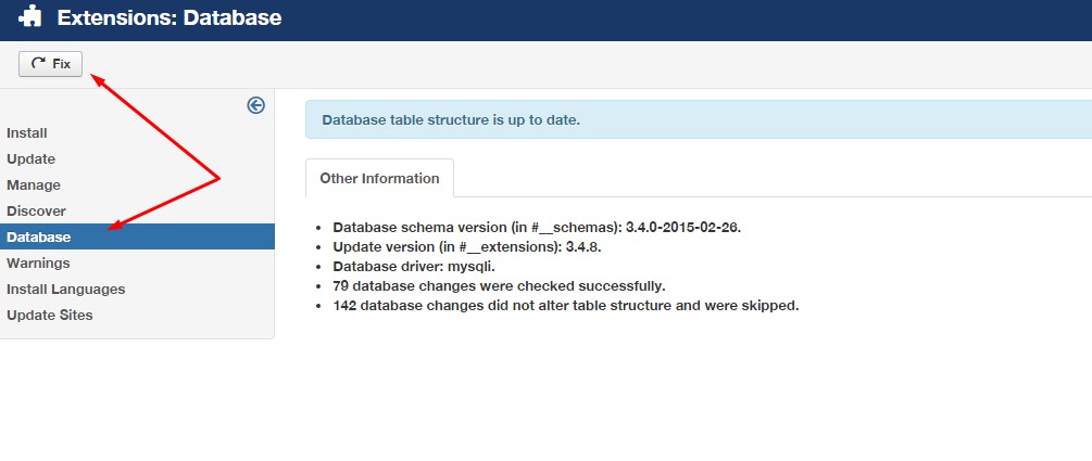

You can try to fix it in this way
1) Uninstall Ja Extension Manager component
2) Uninstall the JA Disqus Debate Echo Plugin
3) Go to Extensions -> Manage -> Database -> and click on Fix button at top
4) Download and reinstall again the Ja Extension Manager component
5) Download and reinstall again the JA Disqus Debate Echo Plugin
6) Try to see if it is fixedHope it helps

Unfortunately, it seems there is another problem. I can’t uninstall Ja Extension Manager (or anything else) because I can’t enter Extensions – Manage – Manage section. it gives me following error:
500 Unknown column ‘a.id’ in ‘where clause’ SQL=SELECT COUNT() FROM myprefix_extensions WHERE state=0 AND a.id != 46 Unknown column ‘a.id’ in ‘where clause’ SQL=SELECT ,2protected+(1-protected)enabled as status FROM myprefix_extensions WHERE state=0 AND a.id != 46 Unknown column ‘a.id’ in ‘where clause’ SQL=SELECT COUNT(*) FROM myprefix_extensions WHERE state=0 AND a.id != 46
I tried Database Fix, but no results…
