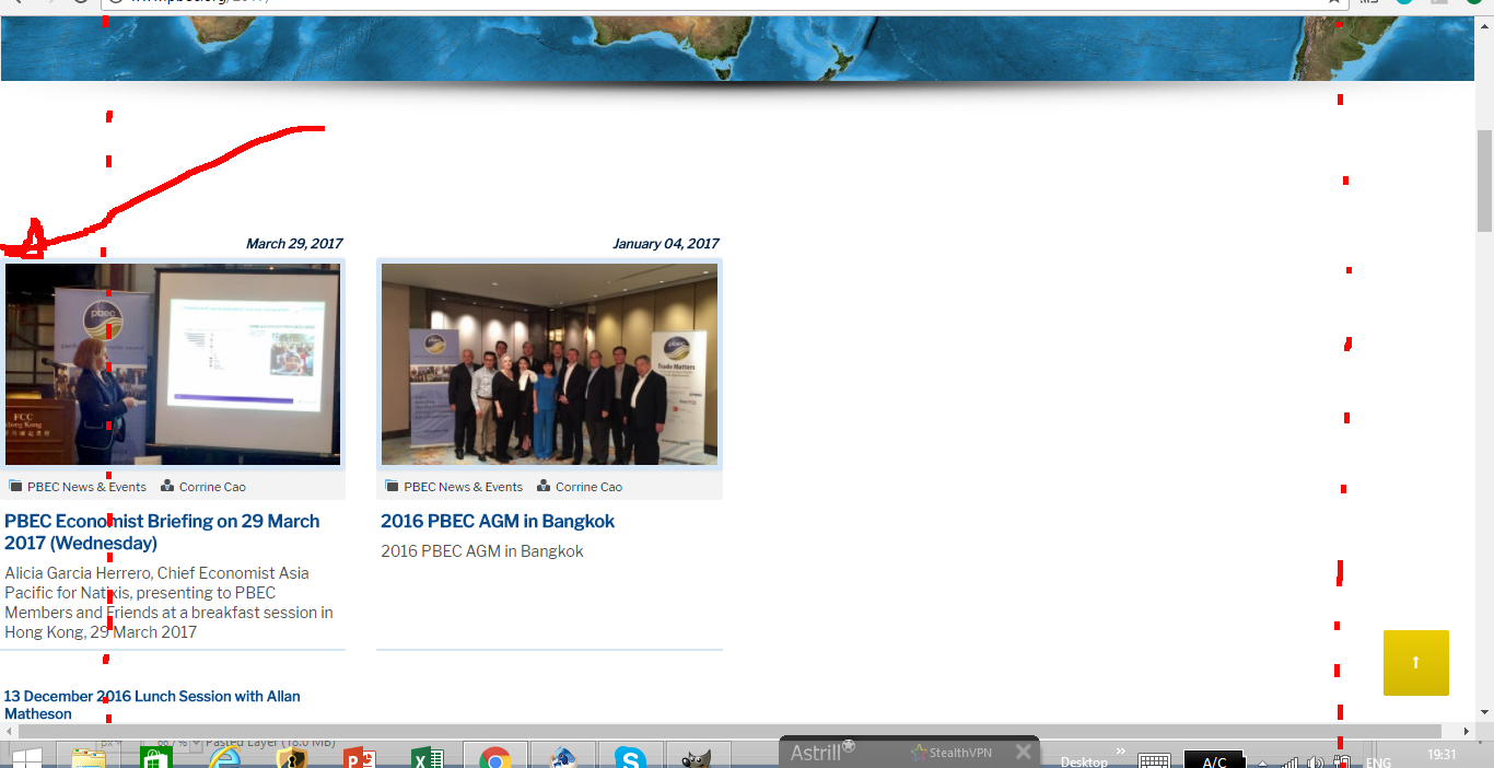

I can’t figure out how to make a module have a "boxed" position, ie where content isn’t going all the way out to the edge. It looks completely stupid to have text that goes all the way out to left and right side of the template with no padding whatsoever. Most templates have (like rockettheme) have functions to choose boxed or full-width, and also to put in padding as needed. I can’t figure out how to do this in JA Company template.

For Screenshot 3, this is NOT dependent on the module. I can put in regular text. This screenshot is from my desktop view. What I want is to have "boxed width" not "full width". I followed your link to the tutorial and I understand the description there, but this function does NOT exist in JA Company! Try it yourself, there’s no resize function! I don’t know if this is a mistake, or if the template was released before being tested, or some other reason. It just doesn’t exist. The module position in the screenshot is content-mast-top by the way.

- I still can’t use some module positions because I still haven’t gotten a reply as to why the template width goes all the way to the edge of the screen, and there’s no setting to "box" the content (lie some modules seem to have). I can’t imagine a template where the module content MUST go all the way to the edge of the screen, any title, text etc that does that looks horrible.

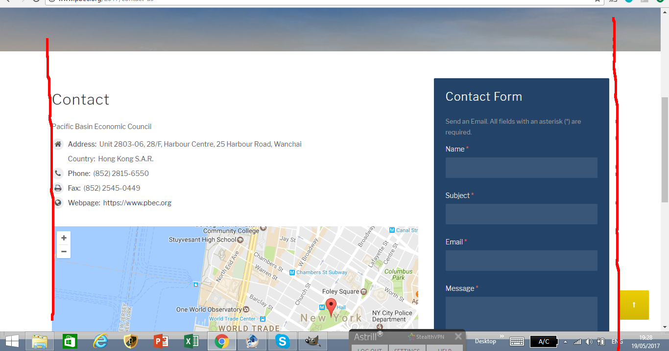

Its very simple. Module "position 1" has a "boxed" layout. Ie the content doesn’t go all the way out to the screen edge.
Why isn’t there a setting in the layout manager where you can set this?
I really just want my money back, this template has been useless. Not at all up to Joomlart’s normal standard. I don’t want to have to mess with custom CSS for simple module layouts that other companies such as Rockettheme has set as default.
This template has been one huge disappointment…
May 19, 2017 at 12:35 pm #1035423Attached are two screenshots if that will help. I cannot figure out why a setting that allows for the module to have either boxed content or full-width is so difficult to do. I thought this was standard today, at least based on other template providers i have tried.

May 20, 2017 at 2:37 am #1035545Hi
some of the position used in the template are full width, Kindly add
a module suffix: container
and you will have the container width if you have any issue to add the module suffix kindly share the Page URL where the module is published a temp super user login of the site I will fix this for you.Regards
