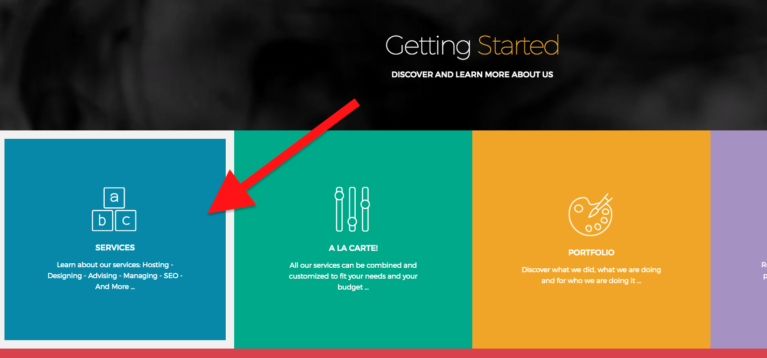

It seems that JA Builder is affecting the way URL are used by other modules on my site.
I have "deluxe news pro" module from Joomlaxtc.com which automatically link to articles. Everything was working find until I create a page connected with the menu items which display the article itself. The idea was to use JA builder to add elements to the page. Unfortunately, it replace the page completely which is fine for me, but once the page is published, the menu item is working correctly, but the links display from the module doesn’t redirect to page created anymore.
Is it possible to correct this? Thanks
Please, see site details for instruction on how to replicate the issue.

May 20, 2017 at 5:29 pm #1035631Hi, I wasn’t clear enough sorry. I am not using JA builder as default template.
The menu item "Services" is an alias from a single article menu items (from "Hidden Menu 1") I create to display the specific article.
Now everything was working as expected until I tried to create a page from that menu item (single article) hoping it would let me add content (blocks) to that articles page.Unfortunately, When I created the page from the single article menu item with JA builder, the article disappeared, and the links from the module was broken!
