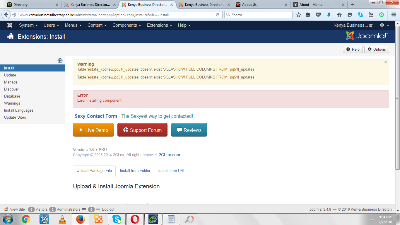

I am using the JA Directory and I have been unable to install any extensions so far, I have tried several times with several extensions. I get an error message as in the screen capture attached.

February 4, 2016 at 10:41 am #876246Hi @vincentochus,
In Extensions: Install page, please switch to tab Database >>> choose Fix to fix any problem in your current db and try again.

February 4, 2016 at 5:13 pm #876497Hi @vincentochus,
In this case, please clarify in detail about the task you’ve done before the problem appear, it would help me to understand the problem better. There must be an incorrect update / install of Joomla! or 3rd party extensions that cause the error with database.
February 4, 2016 at 8:51 pm #876656After I had installed the template successfully, I installed the Simple Image Gallery Pro (K2 addon) without a problem. But then after then I started getting errors whenever I installed any other extension

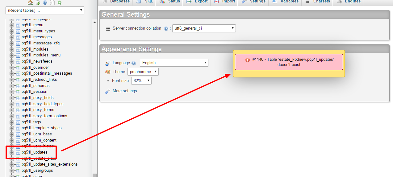

February 7, 2016 at 9:48 am #878304Hi @vincentochus,
Sorry for the delay in getting back to you. I try to examine your database and see the table _updates is listed on left column but couldn’t open it. There must be a problem with your database so try to contact your hosting provider and ask for assistance in this case and let me know the result.
