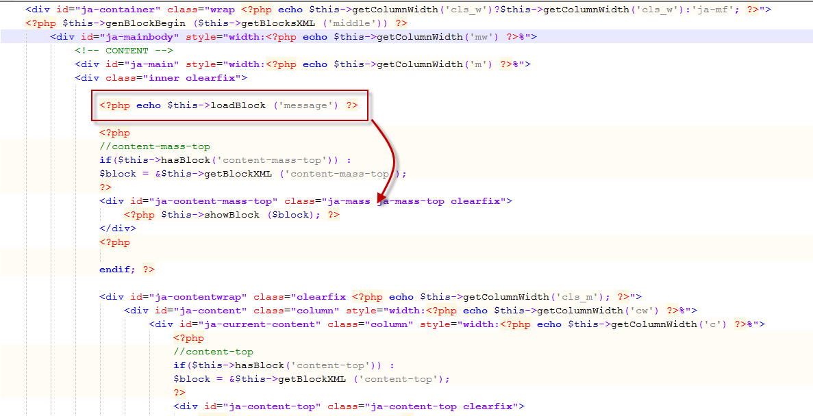

1. You could copy plugins/system/jat3/jat3/base-themes/default/page/default.php to templates/ja_social/page (if page folder isn’t exists, just create it).
2. Open copied file and move block code
<?php echo $this->loadBlock ('message') ?>
inside content mass top
3. Save file & clean T3 cache. Surf to your site.Thanks,

May 11, 2012 at 8:49 am #452556Hi Do Ha,
Thanks so much for your suggestion. It is a brilliant suggestion that didn’t occur to me. If I place the message BELOW the toolbar in the content mass top position then the search box won’t be affected.
I’ve tried your suggestion however the system message is not displaying at all now.
Do I need to make any adjustments to other files, such as perhaps in the layout?
This is how my default.php file looks:
<?php //content-mass-top
if($this->hasBlock('content-mass-top')) :
$block = &$this->getBlockXML ('content-mass-top');
<div id="ja-content-mass-top" class="ja-mass ja-mass-top clearfix">
<?php $this->showBlock ($block); ?>
</div>
<?php
endif; ?>Thanks again.

May 12, 2012 at 2:57 am #452694As you see, there is an if condition to check whether content-mass-top is describe in layout or not. So I think your site layout don’t describe the content-mass-top, so you should describe it.
http://wiki.joomlart.com/wiki/JA_T3_Framework_2/Guides#Enabling_mass_positions
I hope it helps!

May 14, 2012 at 3:35 am #452886Hi Do Ha,
I’ve made some progress. I have added the block to the layout however I have an issue when I display the message:
1) When the message appears for the jomsocial component the menu bar is actually part of the component and not seperately displayed in a module position so in this scenario the message still appears above the component and pushes the alignment.
When I change the order of the code like follows below then nothing is displayed:
<?php echo $this->loadBlock ('message') ?>Do you have any other suggestions?
