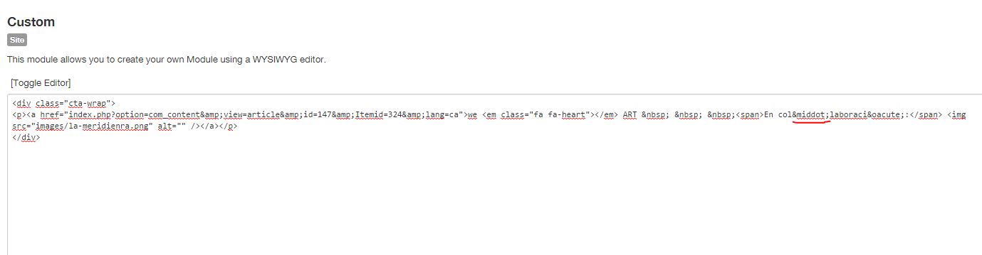

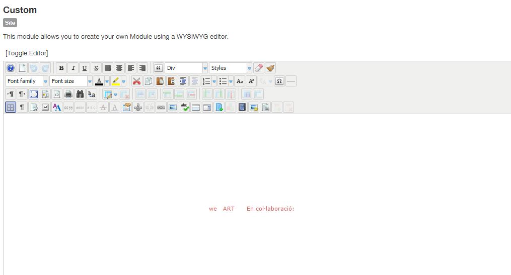

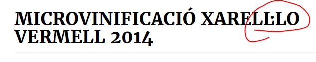

Hello, I have a problem with the font merriewether because when i put a middledot ( · ) the previous letter doubles (only if this letter is a L and only in catalan language). Add 3 images to show you the problem. How can i solve it?

As i can see the screenshot the mid dot is showing fine on front end . When u checked the source code it convert into mid dot.
I suggest you to check this the editor support team for its formatting in the source code . It seems you using JCE editor .Regards
May 5, 2016 at 8:36 am #927026The front end is the only that shows bad, it must be col·laboració not coll·laboració. The problem is not the middledot, is the double L before the middledot in the front end.

the problem is that i type:
L · L (ONE "L" "·" ONE "L")and results in:
LL·L (TWO "L" "·" ONE "L")
thanks

May 12, 2016 at 10:13 am #929879This reply has been marked as private.May 17, 2016 at 8:26 am #931469Hi , it’s not solved. This is a custom html so i can controle it because i use other things. But in Titles and paragrafs the problem still happen.
See it here
http://enconstruccio.net/avgvstvs/ca/vins/microvinificaciones/105-microvinificacio-xarel-lo-vermell-2014
