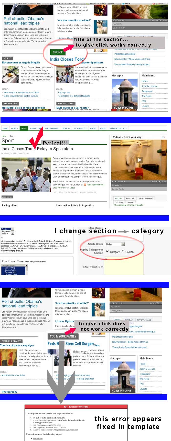

Grettings!!!
the configuration JA News with the sections of the site joomla! works very well in the frontal part.
but the configuration with the categories broken connections in the the titles of the categories are created
with the attached image I explain the error in detail.
Thanks.

August 6, 2008 at 3:50 pm #264123I believe you also need to also change the TYPE from Section to Category in your MENU MANAGER…

August 6, 2008 at 4:59 pm #264143already, did I it, but she does not work, she tries to do it in your template and you will see
it observes the attached, there specific image step by step the problem.

August 6, 2008 at 5:23 pm #264144Okay…
Well I am confused by part of your attached image…in the middle where you indicate
“I change section —> Category”Where are you doing this…what Section and or category. The image is not showing enough for me to understand where in the Admin are you are trying to make the change.
Thanks,
John.August 6, 2008 at 5:35 pm #264145the steps that itself to change the configuration are:
Extensions – Module Manager – Ja News – I change section by category.
when I do this, she works well, but the titles of the categories are broken links, as I show in the penultimate and last image that attached.

November 12, 2008 at 5:11 pm #278980Did this get fixed as I have same issue with some articles that I create onto front page that always go to 404 page? any ideas helpful..

September 26, 2011 at 6:28 pm #415117I have the same problem!!!!

September 26, 2011 at 6:54 pm #415119Can you provide me with a URL, or better yet, an admin login so I may look at the configuration in the back end.
It appears once you switched to CATEGORY that you did not include the correct “Category (Section) ID” number.
John.

September 26, 2011 at 7:05 pm #415124http://southernjewelrynews.com/
I will PM you with login nowspencermjax Friend

October 2, 2011 at 12:53 pm #416211Here is a solution i came up with…..
I can’t tell if those changes will have repercussions elsewhere so modify at your own risk.in the file /modules/mod_janews/tmpl/blog_item.php
I changed 2 instances of $row->catslug to $row->catidfind BOTH instances of this:
$link = JRoute::_(ContentHelperRoute::getArticleRoute($row->slug, $row->catslug, $row->sectionid));Change TO this:
$link = JRoute::_(ContentHelperRoute::getArticleRoute($row->slug, $row->catid, $row->sectionid));1 user says Thank You to spencermjax for this useful post
