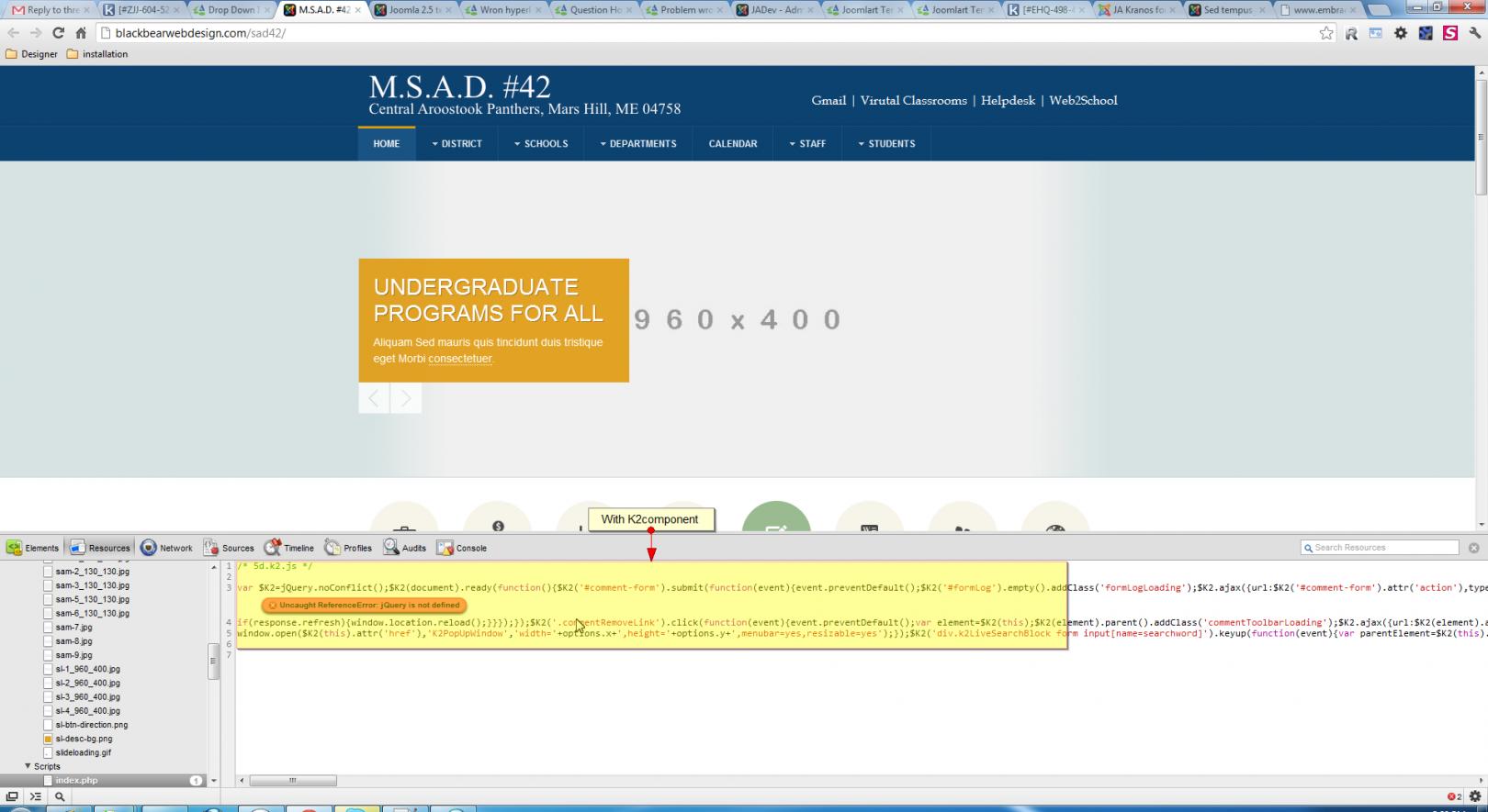

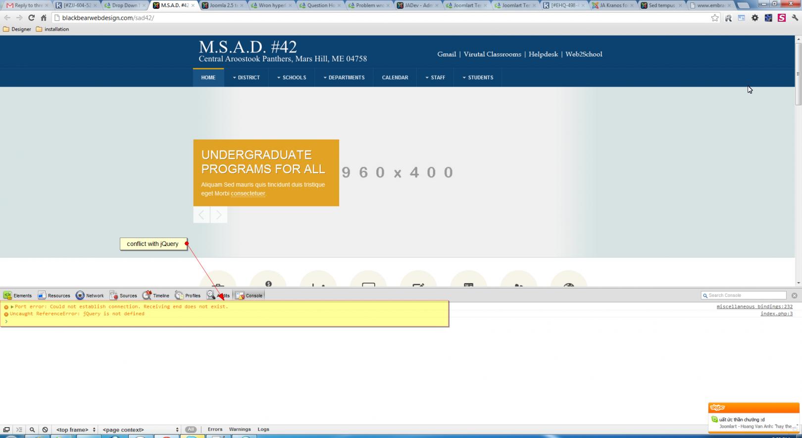

September 13, 2012 at 8:39 am #466910@ametzler79: I debugged to check the link on your site, i see that your site is conflict with jQuery of K2component
and @1option: may be you have the same problem
Please check add this script below jQuery lib
<script>jQuery.noConflict();</script>The problem on your site will be fixed.
