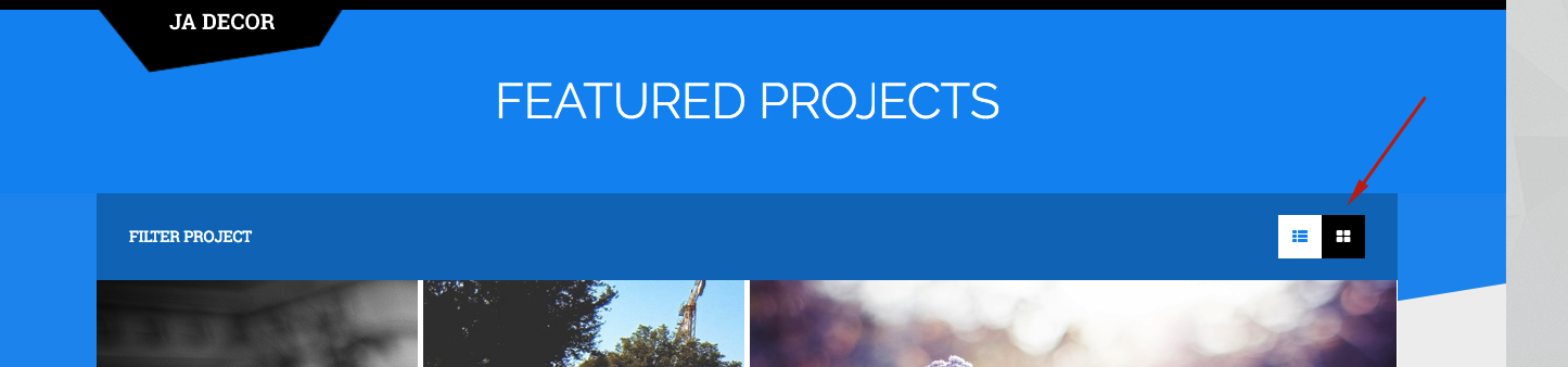

where is the difference between the "Our Service" and the "Features Projects"? I compared both modules and I can not find any differences between them. Where is the setting to show like "projects" or like "services"?
- When viewing all "Features Projects" there is a filter on top and you can change the view. I want to hide this and always view in picture or grid mode. Where to set this up? Where is the setting that the filter is showing up?

There is no backend settings to hide filter but you can easily achieve it adding a css snippet to the custom.css file in this folder /templates/ja_decor/css/ If you do not have already such file then create a new one with following code inside it
.ja-masonry-wrap .toobar-grid .dropdown .btn { display:none; }Hope it helps
