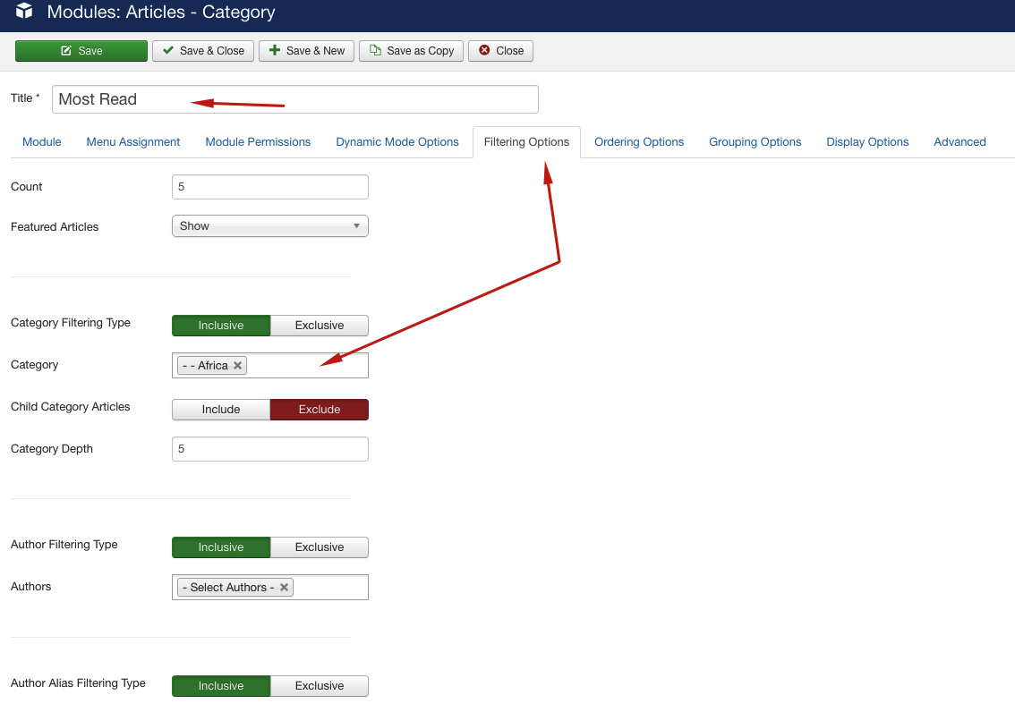

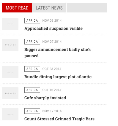

October 5, 2016 at 8:52 pm #973866Greetings. How can I create a side tab (check attached image)that displays the latest and most read articles from one category only?
thank you
October 5, 2016 at 9:14 pm #973874Hi
First you will need to create a custom module with below code and publish it in sidebar-1 position
Code :
<div><!-- Nav tabs --> <ul class="nav nav-tabs"> <li class="active"><a href="#home" data-toggle="tab">Most read</a></li> <li><a href="#profile" data-toggle="tab">Latest news</a></li> </ul> <!-- Tab panes --> <div class="tab-content"> <div id="home" class="tab-pane active">{loadposition tab-1}</div> <div id="profile" class="tab-pane">{loadposition tab-2}</div> </div> </div>Then create an articles category module and publish it in tab-1 position and a latest news module published in tab-2 position

October 6, 2016 at 8:26 am #974047Hi
This module already exists as default. I would like to create another one for a single category.
when I follow your steps it keeps changing the default module.pavit Moderator
October 6, 2016 at 3:33 pm #974185Modify code above as showed below to add a new tab position.
<!-- Tab panes --> <div class="tab-content"> <div id="home" class="tab-pane active">{loadposition tab-1}</div> <div id="profile" class="tab-pane">{loadposition tab-2}</div> <div id="profile2" class="tab-pane">{loadposition tab-3}</div> </div> </div>Publish a new module in tab-3 position
