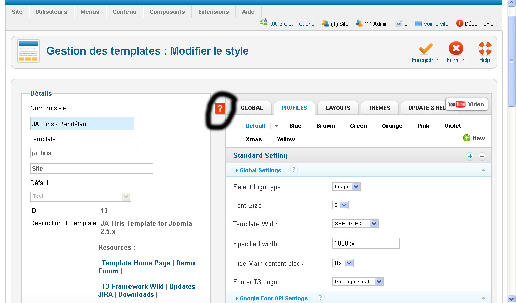

June 7, 2012 at 11:24 am #456491This is what I did but, as rickozoid2 said: After i make changes and try to save them, the apply loading icon keeps going around and around, without giving a response at all, and not saving the changes. and the question mark is red, see on the printscreen:

June 7, 2012 at 11:31 am #456493Have a look at your permissions (as mentioned above) at /administrator/index.php?option=com_admin&view=sysinfo and check on the directory permissions. All should be writable.
If you want to change them or make sure they are set as should be then the easiest way is to download Akeeba Admin Tools and use that to set permissions. While you are at Akeebabackup.com download the backup tool – the best tool you will ever have for Joomla.

June 7, 2012 at 12:11 pm #456500All files are writable, is there anything else I can do?
