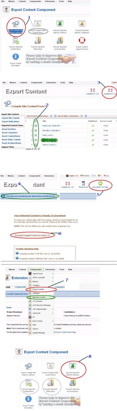

December 23, 2010 at 1:23 am #368212Hi Filmlover7,
check out the attached image at the end of this post
I am using Teline iii v1 at present and I am planning on moving to teline iii v2 once its template for Joomla! 1.6 is available.
This is what I would have done and plan to do :
1- Backup your site entirely
2- Go to Joomla Extensions Directory and download this extension: http://extensions.joomla.org/extensions/migration-a-conversion/joomla-migration/4054
(You would need to activate the legacy plugin for it to work. After you finish with this component, you can disable the legacy again as it would not affect its fonctionality.)
3- Go to your current site and make PrintScreen all your modules and plugins and also extensions, so you know what you have installed in your current version.
4- Enable the legacy mode and Install the above extension (Export Content). Once installed sucessfully, then go to Components > Export Content > then choose how you would like to export; by Sections or by Content items. (Exporting the sections would give you all the Sections + Categories + Articles, whereas exporting jus the static content items would only give you those items. I would export by Sections). Once you have clicked on your choice, then select the items you would like to export. If you have selected the Sections, you would only chose the few sections you have to export.
5 – Follow the image I have attached here for you to see what to expect. I have numbered the step to follow, so just follow each step accordingly.
Once you have reached step 8, then make your choice on how you would like to insert the imported content. Then select what to insert and click on INSERT (near the top right hand side).
All your (Sections, Categs and Articles if you have selected to compile by section) content should be there.
Now go to your menu manager adn do the rest.
Once you have finished all that, just uninstall the Export Content and Imported Content components as usual and do not forget to disable the legacy mode if you do not need it enabled.
Finally, if you use this method, please send your feedback.
I hope it works for you.
See attached image.
