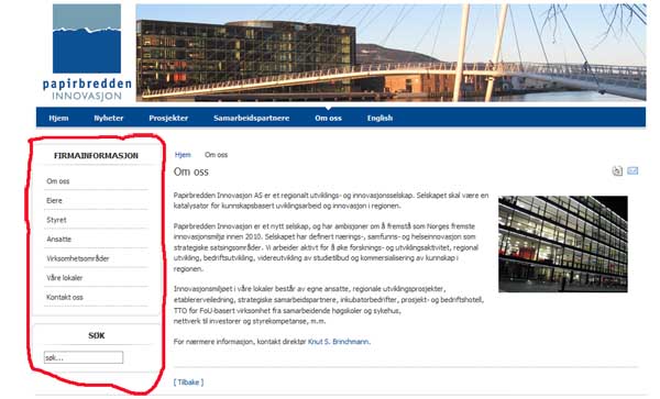

I am wondering how i can change the layout of the JA Avian ii m to have the menu on the left side of the template?
See attached screenshot and index.php file
Where do i change the code to make this work? I am using Joomla! 1.0.15 Stable
Regards Powder

May 26, 2008 at 5:28 pm #250611Skal du bruke siden sånn du har satt den opp idag?
Isåfall kan du prøve dette:
Åpne template_css.css filen på line 711(template_css.css på joomla 1.0.xx og template.css på joomla 1.5):
#ja-col2 {
float:right;
overflow:hidden;
width:49.9%;
Forandre til:
#ja-col2 {
float:left;
overflow:hidden;
width:49.9%;
Også finner du line 668:
#ja-content {template_css.css (line 668
background:transparent url(../images/content-center.gif) repeat-y;
float:left;
width:58%;
Og forandrer til:
float:right;
width:58%;
Ill post the same in english too:
Find line 711(template_css.css in joomla 1.0.xx and template.css på joomla 1.5):
#ja-col2 {
float:right;
overflow:hidden;
width:49.9%;
Change to:
#ja-col2 {
float:left;
overflow:hidden;
width:49.9%;
Then find line 668:
float:left;
width:58%;
and change to:
float:right;
width:58%;
If you should have any problems doing this let me know. Or if it’s not working as it should.
