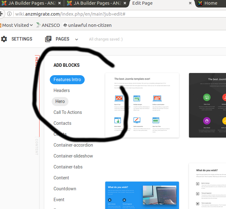

    I’ve installed under various versions of Joomla (3.5, 3.6, 3.7) and have the same problem. I’ve also tried installing under quickstart JA installations and same issue.
    Under the ADD BLOCKS I cannot select other blocks to add. Using your demo site I can, but I can’t on my own site. I am able to connect my login (I’ve tried disconnecting and reconnecting and same issue).

    1. Screenshot-from-2017-05-07-19-17-06

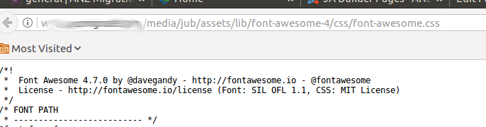

    I have logged in and it’s the same problem. I can see the blocks listed but I can’t select any. I looked at your screen shot, the first file with the 404 not found error doesn’t exist. See the screen shot below where I checked the files on the server.
    I tried using the console display as you used. I also get a 404 error for a file. Yet the file IS on the server and I can access it when I put the url in my browser. I also logged on to the server and try using wget and I get access the same file without errors. It’s only showing in the error under JA Builder. I’ve attached screen shots.

    2. file-is-there
