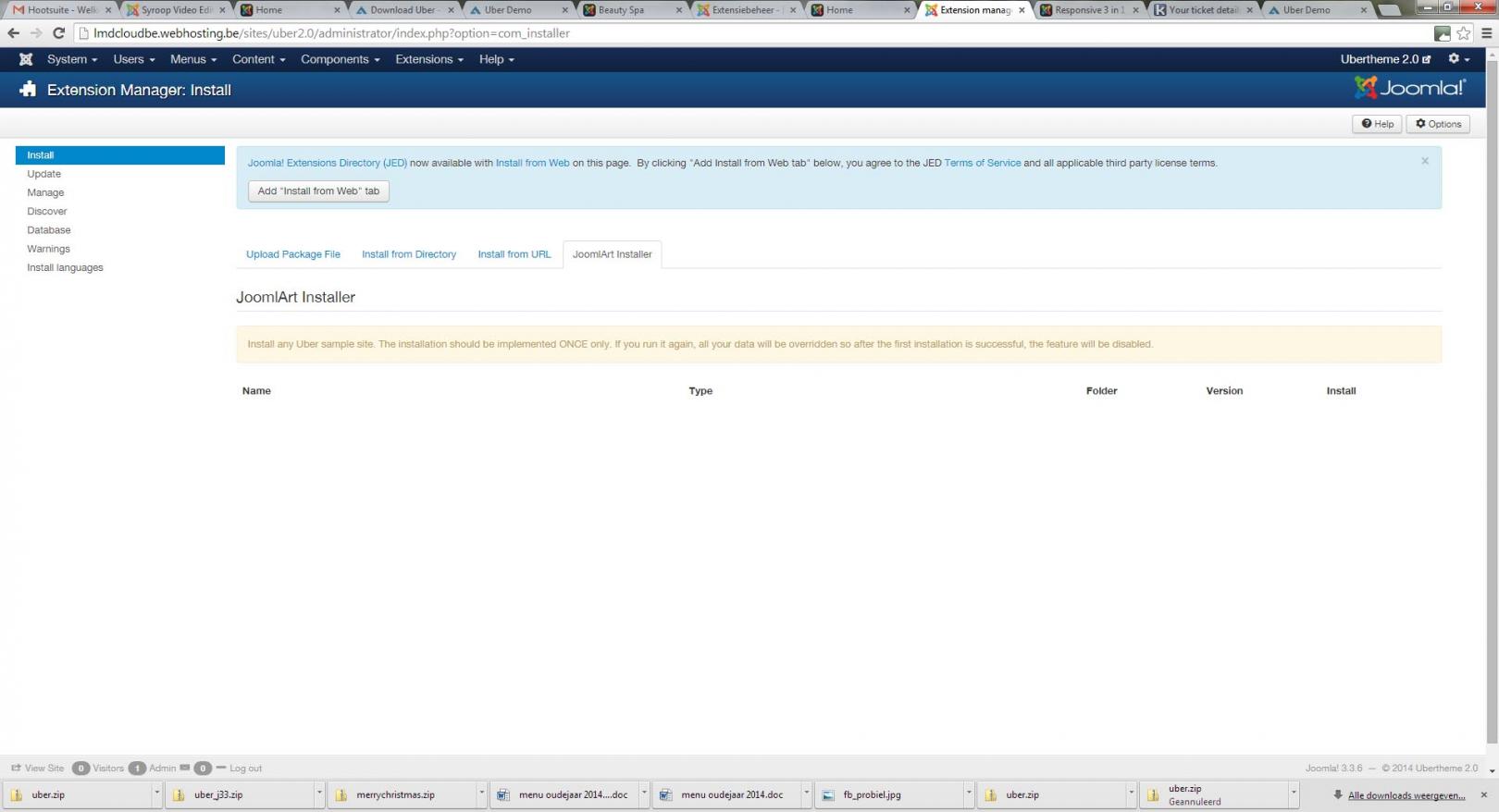

November 12, 2014 at 5:18 am #554932Hello,
i also followed all the steps of a normal installation, as i did maybe 100 times before, but when i go to the extension manager(*), i cannot see the sample data to install.
How does this occur? See also the added print screen.
thank you for your help,
marK
*Step 1″ : (Access your site back-end panel, go to Extension > Extension Manager. Navigate to the JoomlArt Installer tab, install the sample site package you want. )

November 12, 2014 at 8:17 am #554958Dear Viet Vu,
i did the install for the third time, and still nothing has changed! So I tried the fourth time ๐
this is what i get: the sample data install is succesfull!
But when i remove the installation folder, i get these messages:
When i go to ../administrator/index.php?option=com_installer, i just see a blank page beneath
JoomlArt InstallerInstall any Uber sample site. The installation should be implemented ONCE only. If you run it again, all your data will be overridden so after the first installation is successful, the feature will be disabled.
Name Type Folder Version Install
… here’s the blank space…
where did i go wrong?

November 12, 2014 at 8:38 am #554959Hi there,
JoomlArt InstallerPlease enable display_errors maximum to inspect if any php fatal error here.
Thank you,

November 12, 2014 at 8:43 am #554960After enabling display_errors i get these messages:
Warning: file_get_contents(): http:// wrapper is disabled in the server configuration by allow_url_fopen=0 in /data/sites/web/comhostprobe/www/sites/ubertheme2.0/plugins/installer/jainstaller/jainstaller.php on line 76
Warning: file_get_contents(http://update.joomlart.com/service/tracking/list.xml): failed to open stream: no suitable wrapper could be found in /data/sites/web/comhostprobe/www/sites/ubertheme2.0/plugins/installer/jainstaller/jainstaller.php on line 76
mark monbaliu Friend
mark monbaliu
- 22
- 59
- 3
- 2
November 12, 2014 at 8:45 am #554961I enabled allow_url_fopen and then i see the sample data at last!
THANK YOU FOR YOUR HELP!
