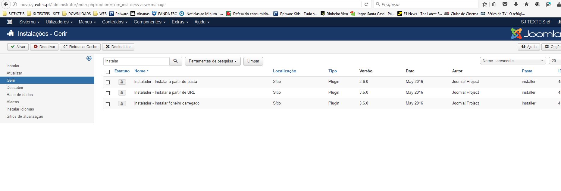

But most important is why I can’t install plugins? In atachment is a screenshot that shows the plugin – Installing from a file – blocked?

September 26, 2017 at 9:55 am #1064160I have just installed the JA Social Feed plugin successfully on your site so it seem there is no issue installing plugins. If you would like to upload whatever you are trying to install somewhere as a zip I will download it and see if I can install it for you.

September 26, 2017 at 10:19 am #1064167Hi,
You are correct.
I try now a gallery and it works, but the easyblog don’t.

September 26, 2017 at 10:42 am #1064171You have in your PHP.ini file a setting that only allows 8mb files to be uploaded. As the Easyblog package is 12mb this explains your problem. How to rectify this does to some extent depend on your hosting. However if you look at the "Warnings" tab in your extensions manager it does give you an option which may or may not work.
Maximum PHP file upload size is too small: This is set in php.ini in both upload_max_filesize and post_max_size settings of your PHP settings (located in php.ini and/or .htaccess file). The maximum file size for uploads is set to less than 8MB which may impact on uploading large packages.September 26, 2017 at 12:39 pm #1064177Hi,
You are correct. It’s not easy to the hosts make that change.
I made the installation by the folder.
Thank you very much for the help.
Best Regards.
