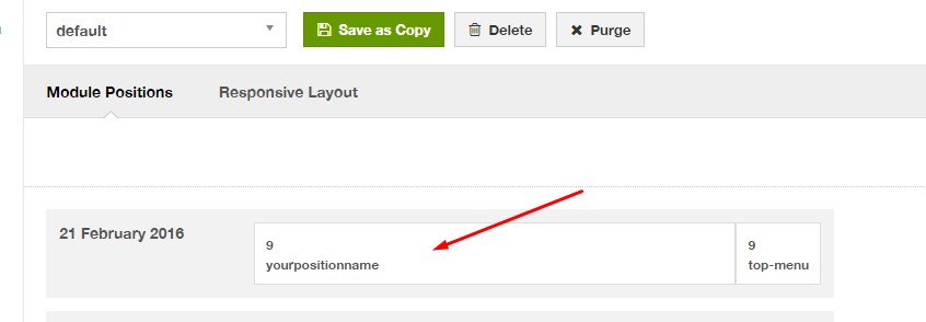

February 21, 2016 at 8:54 pm #887904Hi there
That position is defined in /templates/ja_nex_t3/tpls/blocks/top-header.php file as you can see from my image below, if you want to change it with another position you can edit top-header.php file and declare position name inside it
example
<?php if ($this->countModules(‘yourpositionname’)) : ?>
<div id="languageswitcher-block" class="languageswitcher-block pull-left _c(‘yourpositionname’) ?>”>
<jdoc:include type="modules" name="_p(‘yourpositionname’) ?>” style=”raw” />-

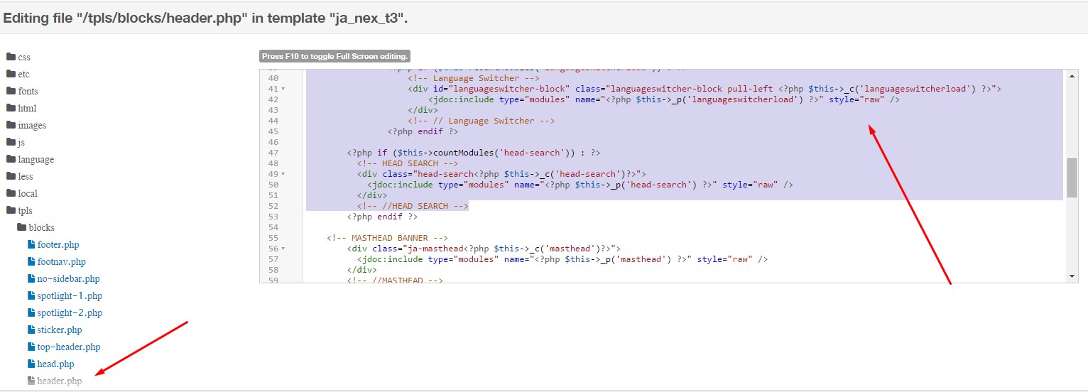

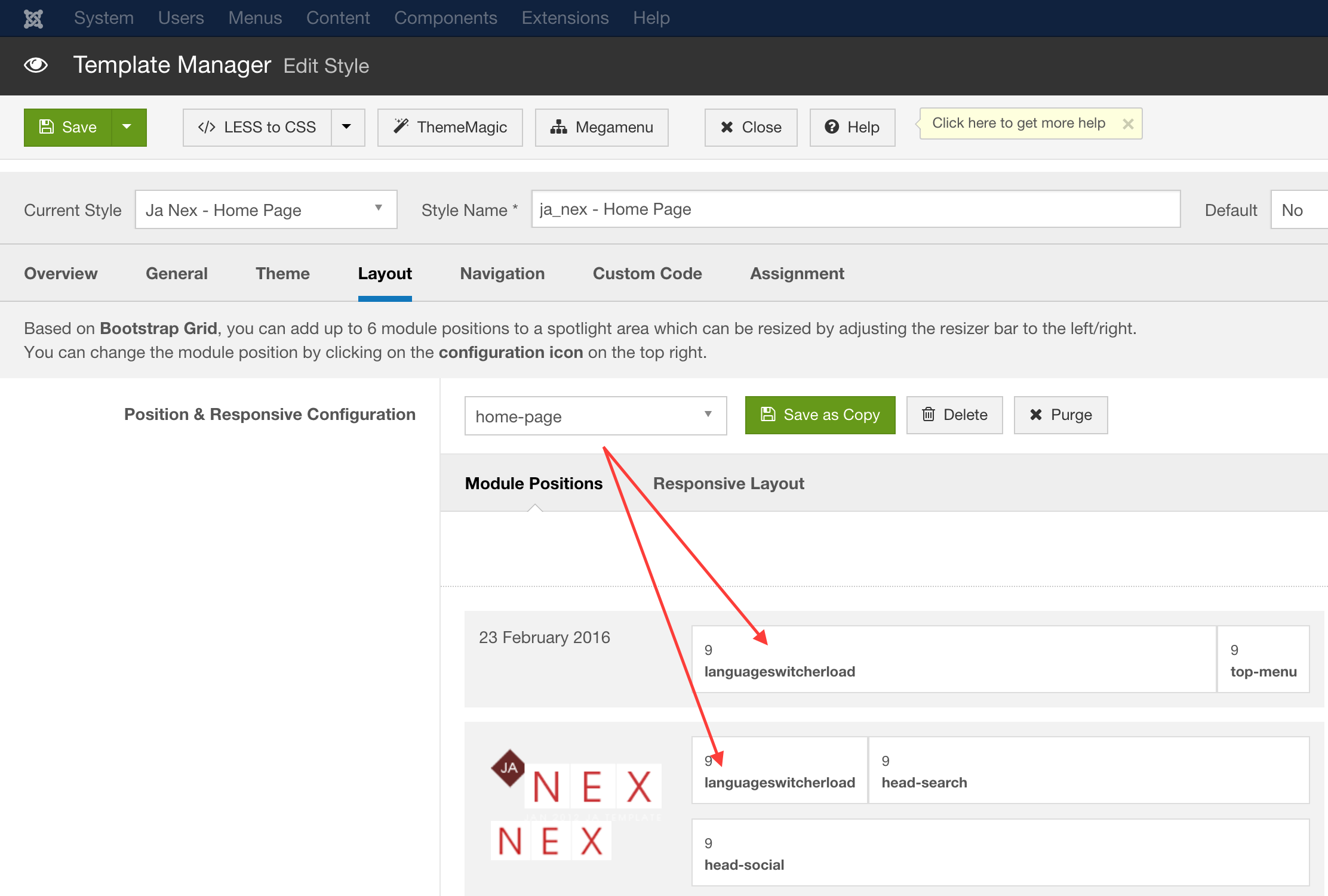

February 23, 2016 at 7:06 am #888921In this JA Nex template has both positions with the same name, see the screenshot and you can not assign other module into languageswitcherload position.
But you can try to use this way to change languageswitcherload position from templates/ja_nex_t3/tpls/blocks/header.php file to other position name
from
<?php if ($this->countModules('languageswitcherload')) : ?> <!-- Language Switcher --> <div id="languageswitcher-block" class="languageswitcher-block pull-left <?php $this->_c('languageswitcherload') ?>"> <jdoc:include type="modules" name="<?php $this->_p('languageswitcherload') ?>" style="raw" /> </div> <!-- // Language Switcher --> <?php endif ?>to
<?php if ($this->countModules('new_position')) : ?> <!-- new_position --> <div id="languageswitcher-block" class="languageswitcher-block pull-left <?php $this->_c('new_position') ?>"> <jdoc:include type="modules" name="<?php $this->_p('new_position') ?>" style="raw" /> </div> <!-- // new_position --> <?php endif ?>Now, you can go back template manager and assign it with other module if you want. Let me know if it helps

February 23, 2016 at 11:24 am #889177There appears to be a misunderstanding. The problem I’m facing is that no changes to the layout get saved in the template admin interface, no mtatter what postion is chosen. Even when I assign the default position to its default placement on the layout, saving doesn’t work.

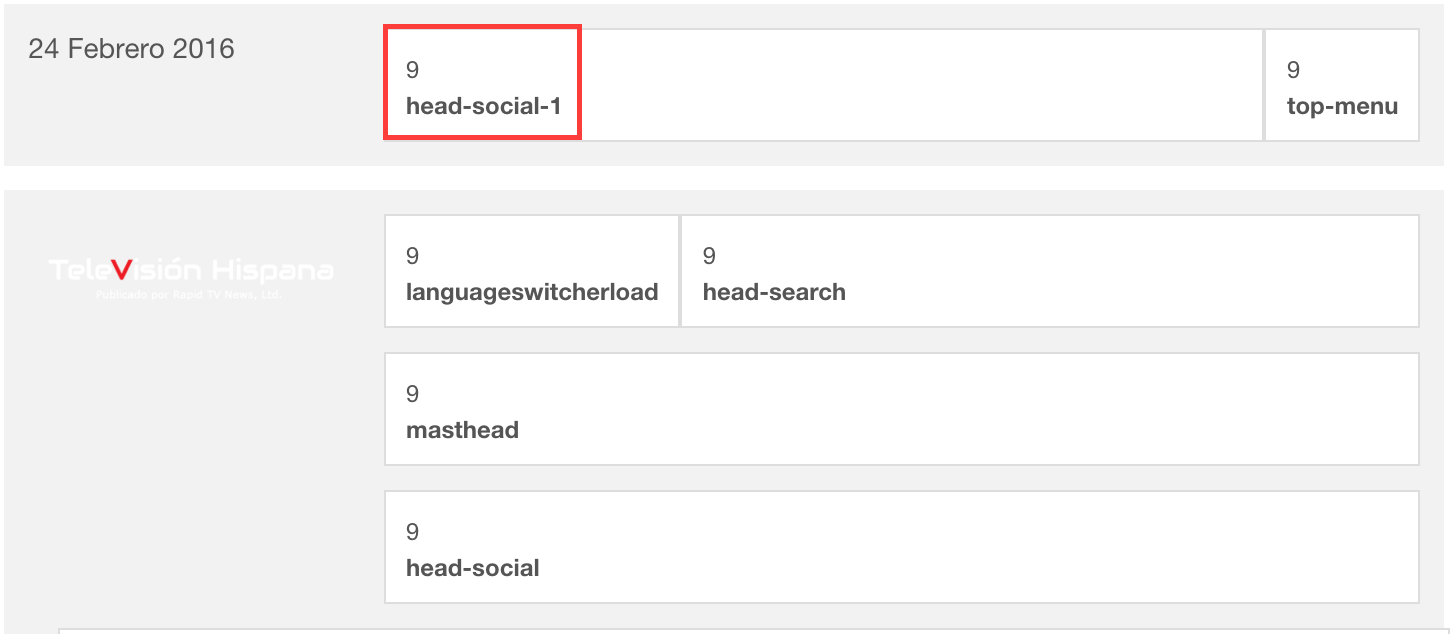

February 24, 2016 at 5:24 am #889523Hi
I got your point but the problem is you’re trying to assign one position (head-social position) in 2 different blocks in the same page, of course, this doesn’t make senses and impossible. In one page, one position should be assigned to only one place.
I changed head-social position into top-header.php file to head-social-1 position, please have a look at my highlight in the screenshot.
Now, you can assign another position name on your template style if you want.
