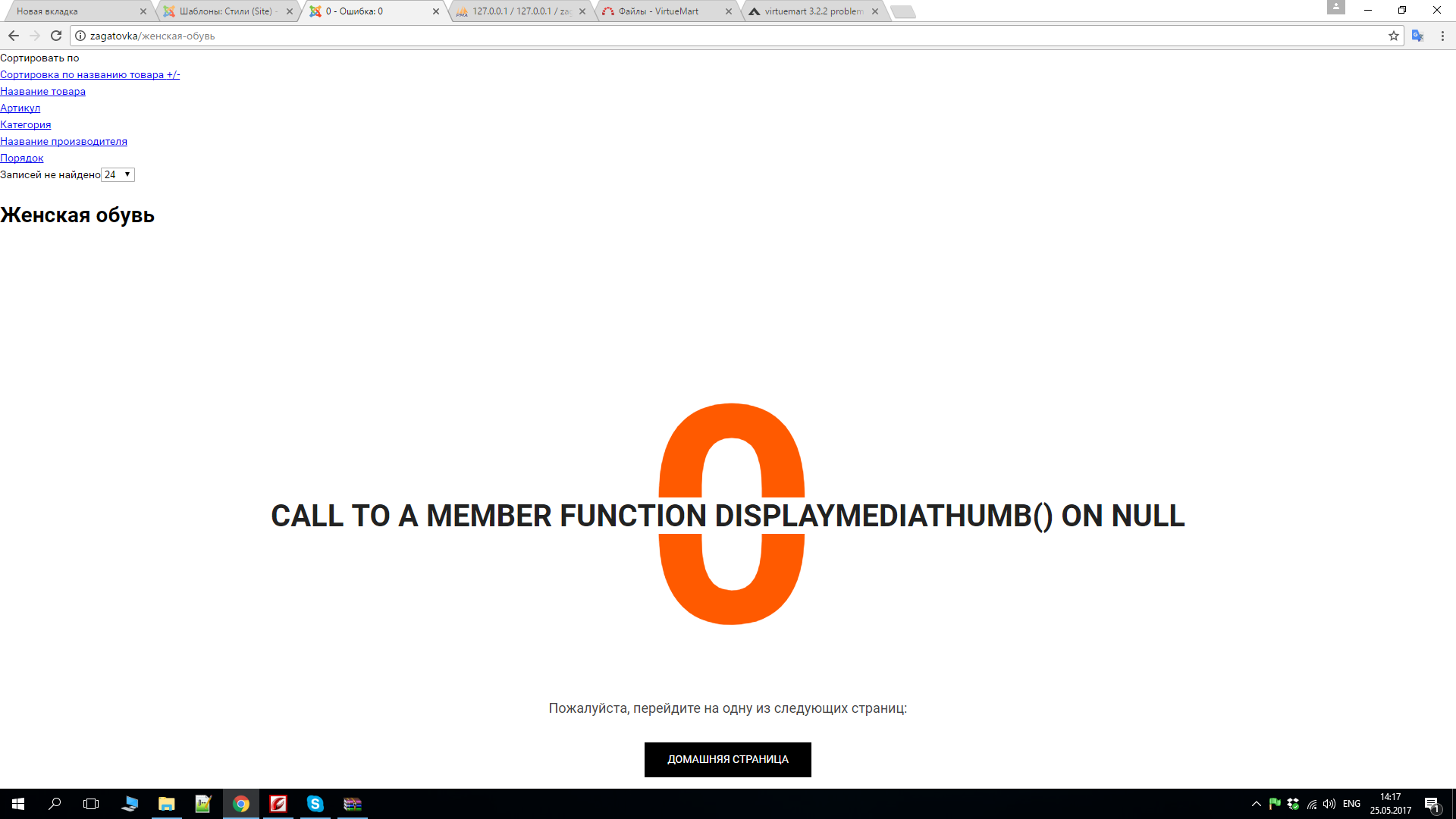

May 24, 2017 at 10:10 pm #1036818This reply has been marked as private.May 25, 2017 at 11:18 am #1036993Hello! Error "CALL TO A MEMBER FUNCTION DISPLAYMEDIATHUMB() ON NULL" in category virtuemart. Could you tell me what to do please?
JA Megastore 1.0.2
Joomla 3.7.2
Virtuemart 3.2.2/3.2.3
