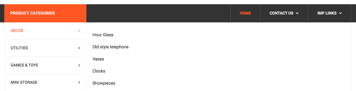

    Hi Team,
    1. Kindly advise, how to reduce the width of vertical mega menu sections. Right now there is lot of empty space in the right, which I want to eradicate. Refer page: http://www.craftofy.com
    2. How to place a banner in a column of vertical mega menu. In your documentation, you have guided on how to place it in the bottom. I want it to be in the right, not bottom.
    3. Want vertical mega menu to be browsed upon mouse hover, not on click.
    Request help.
    1. Screen-Shot-2016-07-06-at-9.54.32-am

    Hi Jaspdeep
    Sorry for late reply ,
    I checked your 3 requests above
    1. This is width of the container and already using the max-width Here : http://prntscr.com/bptokg
      You need to increase his width of the template in case u want to fill the full space .
      see this >>> http://prntscr.com/bptokg
    2. Vertical Menu is menu part is a module position like u can see other modules and loads a menu inside this . It use an override for its layout , this is how u can add the banner via Menu item .
      In case you would like to change the positions of it , you need to make custom work in the
      /templates/ja_megastore/HTML/mod_menu/category.php
      You can see the Code for the load module start line 98
    3. The menu is already seen on hover on your site , you can hover on a menu item and child menu block will open . Please check this again .
