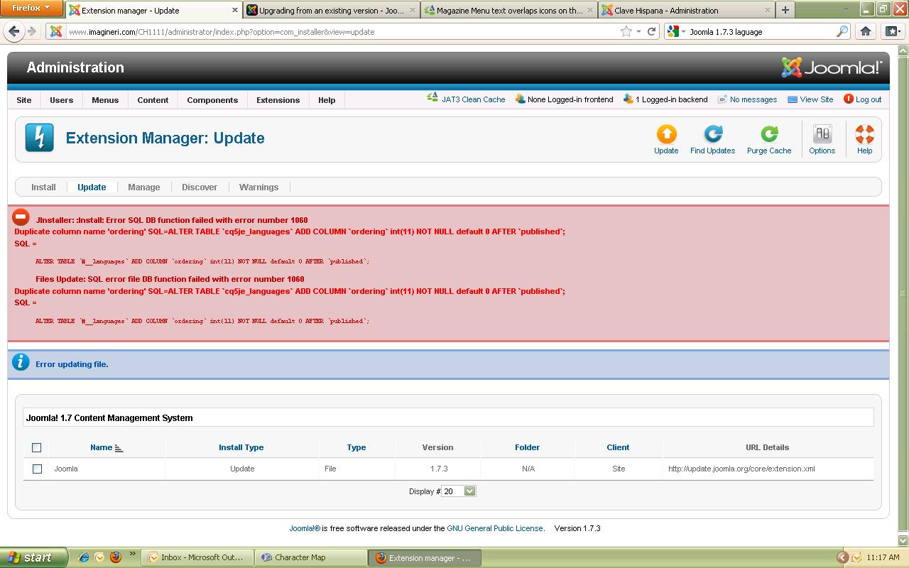

November 21, 2011 at 4:31 pm #170926So I decided to have second brand new install since my first one is having problems, I installed the Joomla 1.7.3 Spanish Pack to translate my site, no problem, I di not assigned the language to be default yet, then I realized that I was running J.1.7.0 quick start from Joomlart, so I decided to upgrade as well, I did the upgrade through the extension manager in the update tab, which found the update and then I hit update btn, it then return and few errors but the version is showing as 1.7.3, so I thought I posted here in case there is anything the developers need to know about this:

November 25, 2011 at 11:25 am #426369Well,
I have faced this trouble before.
The simply way to fix it is go to remove that table – field. 🙂 ( ordering ) ( you can simply do that via phpmyadmin )
And while upgrading , it’ll be add back.Thank you,

November 25, 2011 at 6:20 pm #426433Thanks Jooservices,
Where is that table located in my DB? also this one is just for reference now, I have moved to a third and last installation of Teline IV, after this one I am not spending more time trying to make it work, this Template as perfect as it looks has a lot of bugs, so until the release of Teline V we will see what the developers have done to clean their code.jooservices Friend

November 29, 2011 at 7:33 am #427072Please check this video:
http://www.youtube.com/watch?v=OGBfTjsnGvU&feature=g-allIt’s complete tutorial how to install Teline IV and fix upgrade issue.

November 29, 2011 at 6:20 pm #427186A long video with no editing and no audio, but helpful at the end for me… Thanks
