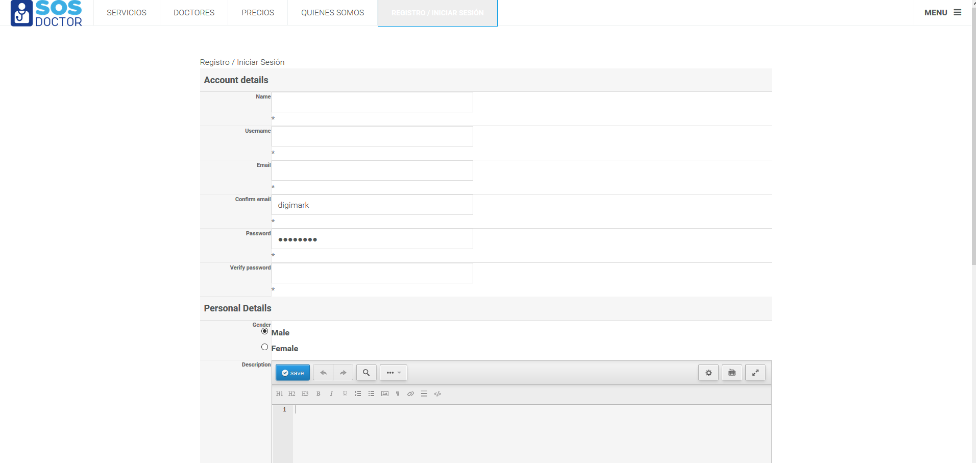

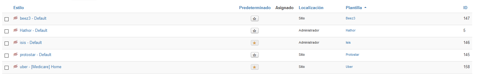

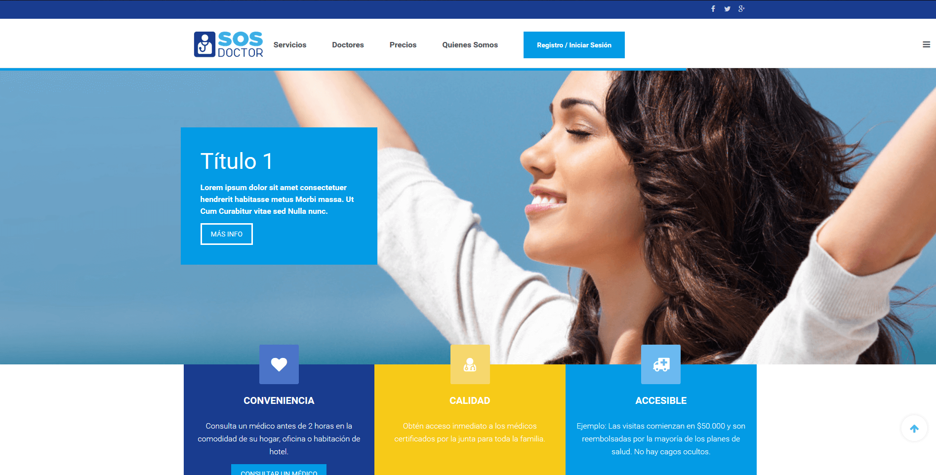

Hi, i hava a problem whit uber medicare template, im working with the quickstart package but it work’s only with pre-installed demo menus. Whit other menus just dont work right and show like the uber home style (not medicare) template. I tried to create a new template style and assign to the correct menu but there is no change. In the template section shows only: uber – [Medicare] Home. That’s strange because in other uber styles with quickstart package shows a lot template styles.
