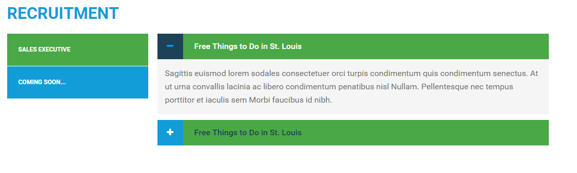

December 31, 2015 at 3:10 am #835616Hi
Links module using Uber ACM Accordion:
SERVICES: http://supplychainvn.com/index.php/services
RECRUITMENT: http://supplychainvn.com/index.php/join-usBoth these pages giving 404 error . Here > http://i.imgur.com/5R6vSE8.png
could u re check it and update me where i can check the problem on your site . Also the product page seems working fine at my end .Ly Long Ly Long Friend

December 31, 2015 at 4:15 am #835727Sorry about this mistake. The above links are ok now.
Best regards,
December 31, 2015 at 5:00 am #835776Hi
Both pages JA ACM module is working fine at my end > http://prntscr.com/9kjh2f
Could u provide steps how to reproduce the problems .Ly Long Ly Long Friend

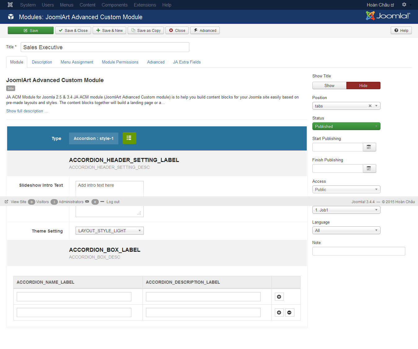

December 31, 2015 at 5:17 am #835779Well, it seem like ok. But, when i want to change content on Uber ACM Accordion, it doesn’t work.
For example JA Accordion Module SALES EXECUTIVE (http://supplychainvn.com/index.php/join-us),
I can’t change and store any content for 2 field ACCORDION_NAME_LABEL, ACCORDION_DESCRIPTION_LABE(links module at backend http://supplychainvn.com/administrator/index.php?option=com_modules&view=module&layout=edit&id=184)-
December 31, 2015 at 5:55 am #835787Hi
its does not seems like its issue due to JA Accordian module becasue the module is unpublished , the problem is may be from the JA ACM itslef , either style not supported here or you did not imported All the files on JA Hotel as given in this doc .
Kindly take a full backup of your site and update T3 plugin and JA ACM module http://prntscr.com/9kjspu to latest version . once done update me with your site FTP details , i will debug the issue on your site .Ly Long Ly Long Friend

December 31, 2015 at 10:07 am #835991Well, many thanks for the advices
Just because template JA Hotel using mod_ja_acm.v2.0.8
But JA ACM Accordion and Tabs we extract form template JA Rent using mod_ja_acm.v2.0.9Just update mod_ja_acm and reinstall ACM package
Best regard,
December 31, 2015 at 10:50 am #836035once done update me with your site FTP details , i will debug the issue on your site .
Is it solved after update ?Ly Long Ly Long Friend

January 4, 2016 at 9:44 am #838125Yes, It has been solved.
Best regard,
