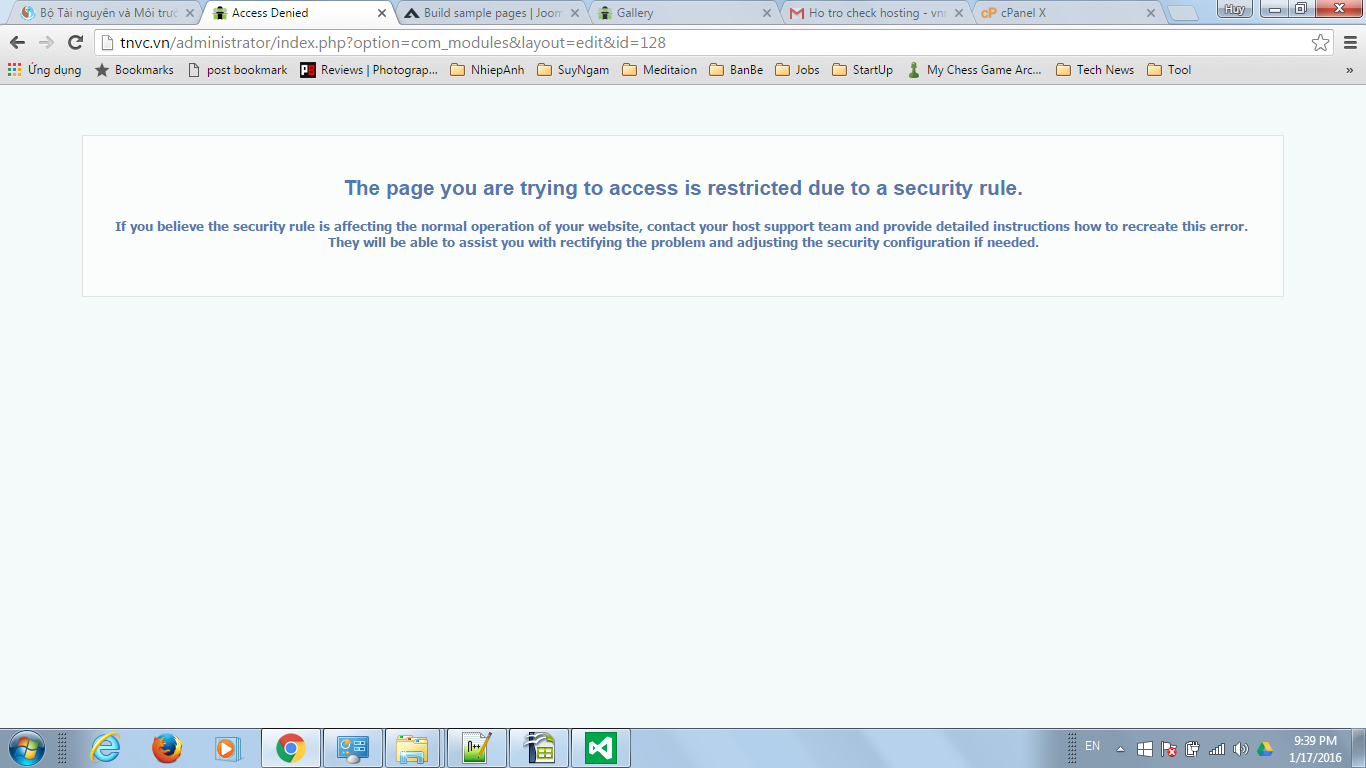

1. Every modules are created succesful, only Gallery module can not save, i do follow your guide but it appear error: ( the attached file)
_"The page you are trying to access is restricted due to a security rule.If you believe the security rule is affecting the normal operation of your website, contact your host support team and provide detailed instructions how to recreate this error.

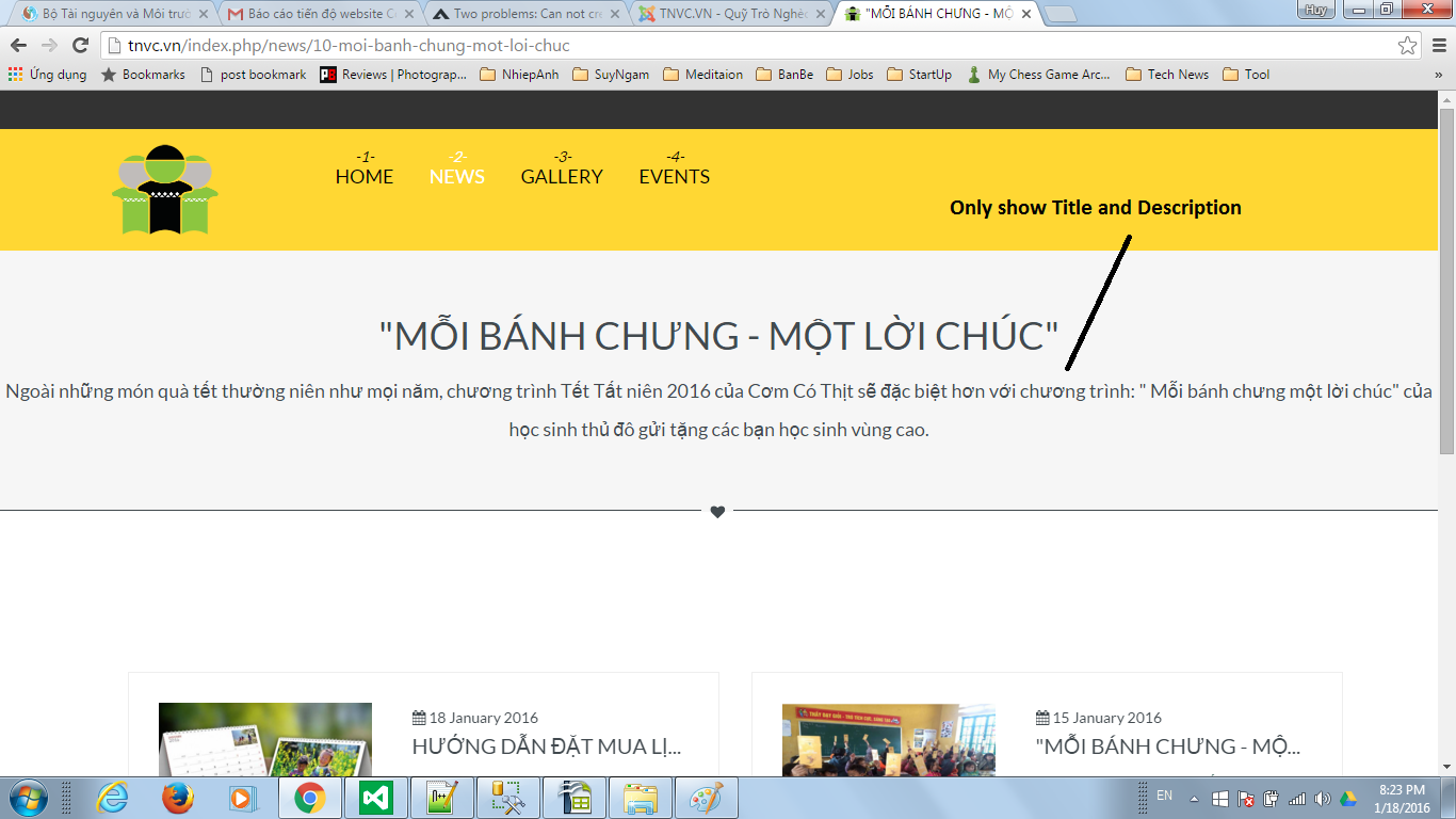

They will be able to assist you with rectifying the problem and adjusting the security configuration if needed."_2: The detail of news can not display: for example: http://tnvc.vn/index.php/news/10-moi-banh-chung-mot-loi-chuc

I’ve fixed by changed the .htaccess file on the hosting. Thanks

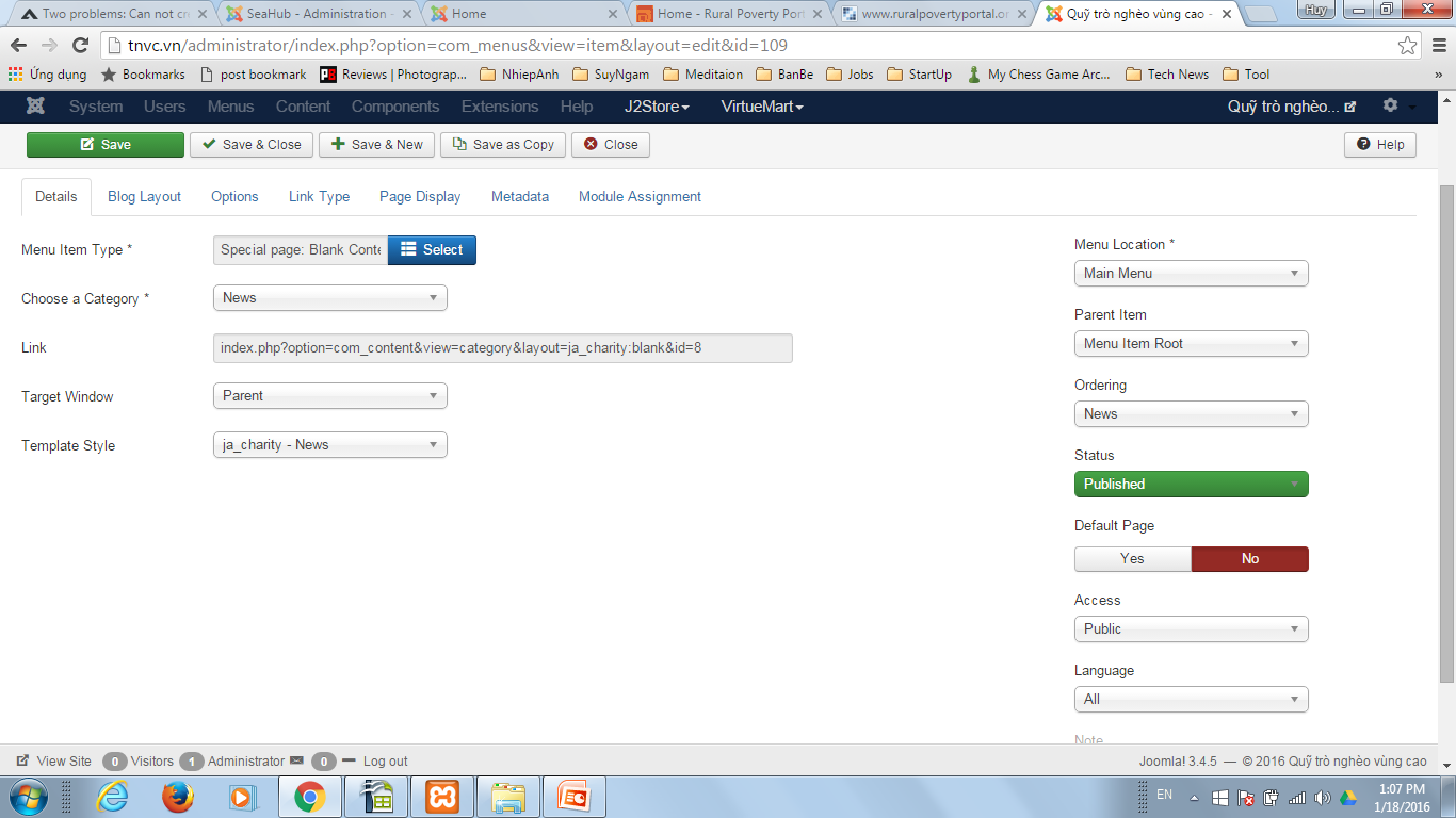

January 18, 2016 at 4:52 am #851291Hello tsuyuri

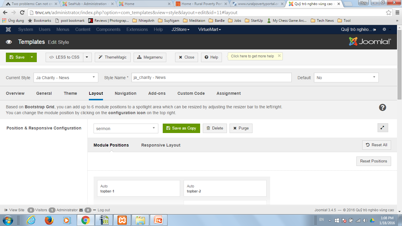

For 2 . It look like the template style you are using for the News Menu does not have component block in the layout . You need to apply a template style for That contains component block in its layout .
You can check the layout from template options > Layout Tab.January 18, 2016 at 5:29 am #851306Thanks

January 18, 2016 at 5:35 am #851307Hi
Open the News menu item and you can see template style option in it .
Let me know if you need any further assistance
(kindly add your site admin details via private reply or edit first post add details for staff/Mods.)January 18, 2016 at 6:09 am #8513252 files attached is my Screen Layout, i’ve set it to my template layout but still did not display correctly

Special page blank content menu type does not load a component block .
Try to apply a sub layout in JA charity news template that have component block .

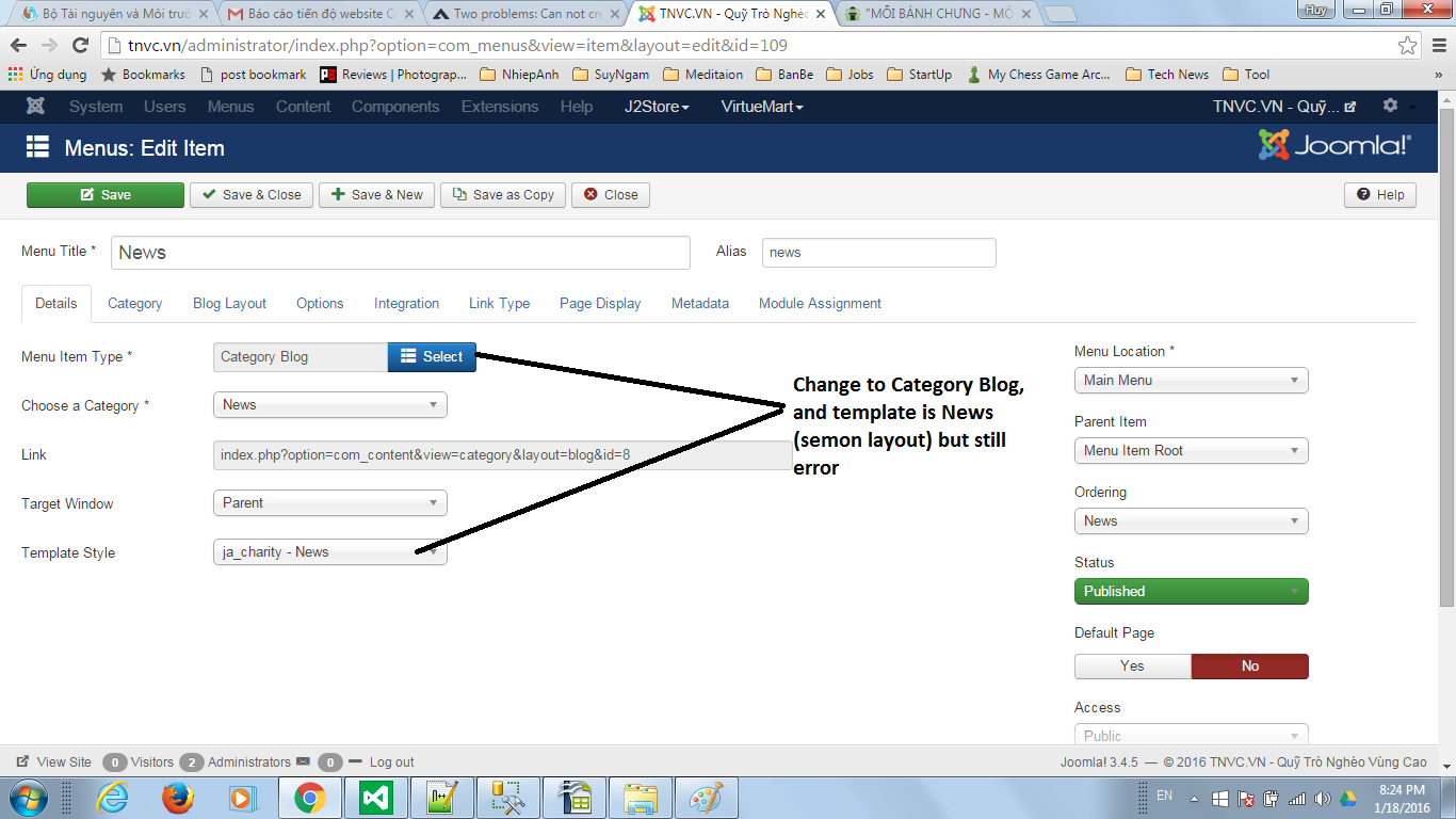

if this does not work you need to change the menu type to featured block or category blog .
because blank content only loads the module positions .January 18, 2016 at 1:27 pm #851770I’ve change to Category Blog and set template style News(Semon), but still can not display news detail, it is only show title and description, not full content.

Oh, i found the solution: Apply a sub layout in JA charity news template that have component block .
Thanks. Fixed it now!
