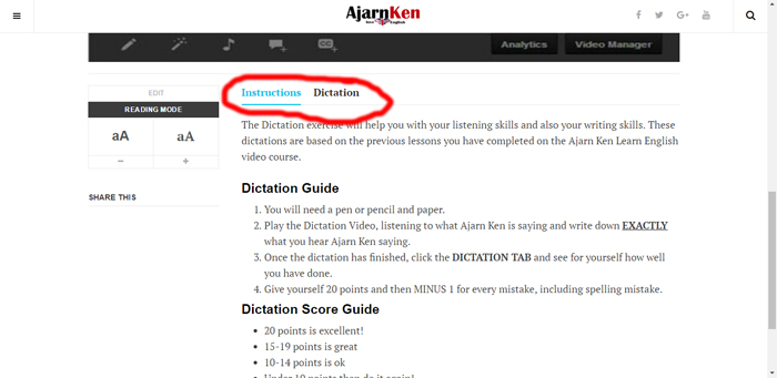

April 22, 2016 at 3:17 am #921299Hi there – I mean the body of the article.
The code for the TABS Typography. e.g. beginning with:
`<ul class="nav nav-tabs"> <li class="active"><a href="#home" data-toggle="tab">Instructions
<div id="myTabContent" class="tab-content"> <div id="home" class="tab-pane fade active in">
etcThis doesnt appear to be working with the NEW ARTICLE type VIDEO.
Hopefully this makes sense!
Kind regards
Ken Thorkildsen

The TAB function on the normal article appears and works fine. If you click the tab options then they change
The TAB function on the video artile appears but doesnt work. If you click the tab option they dont change.
Is there a problem with the TAB function on VIDEO Articles, was my question. Any suggestions??
