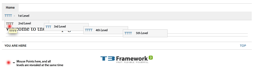

I’ve got a problem with the sub-menus.
I’m using Dropline menu. My menus are complicated and sometimes I need to use sub menus which are 4 or 5 levels down. The problem starts after the 3rd level.
When I point the mouse on the 1st level down, and if there are more than 3 levels down, all the others sub menus (2nd, 3rd, 4rth, 5th level) are showing. The should be showed in order if I’m on 1st level I should see 2nd level down, If I’m on 2nd level I should see 3rd, and it’s working that way as long as there are not more than 3 levels down.
Hope you’ve got my point, If not I’m uploading a screenshot with guidance :laugh:

January 20, 2011 at 2:21 am #372778Hi bobbyggx,
It’s true that the dropline menu only support for maximum 4 submenu levels. If your menu is complicated, the best menu is megamenu. With megamenu, not only unlimited submenu levels support, but you can also organize your menu better. You can group your menu items in columns, you can load module into menu…
