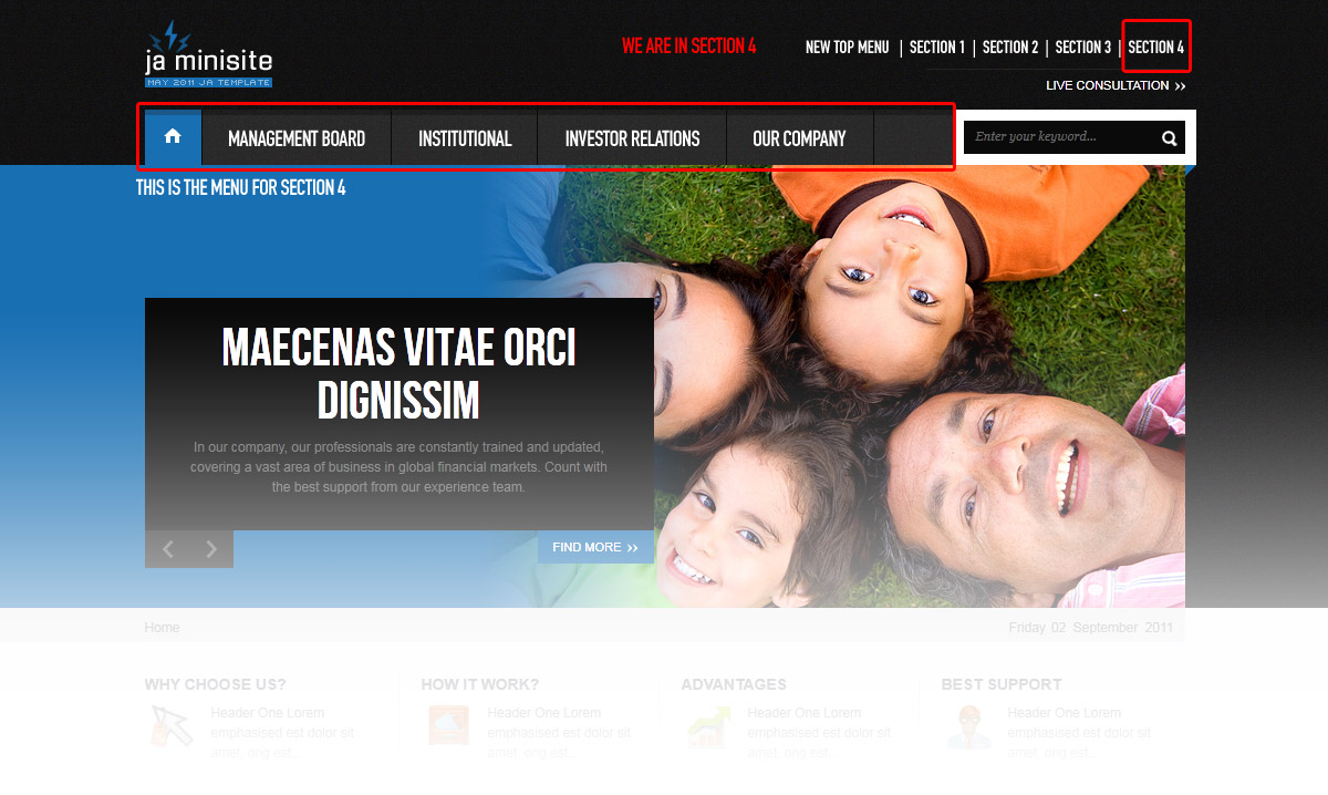

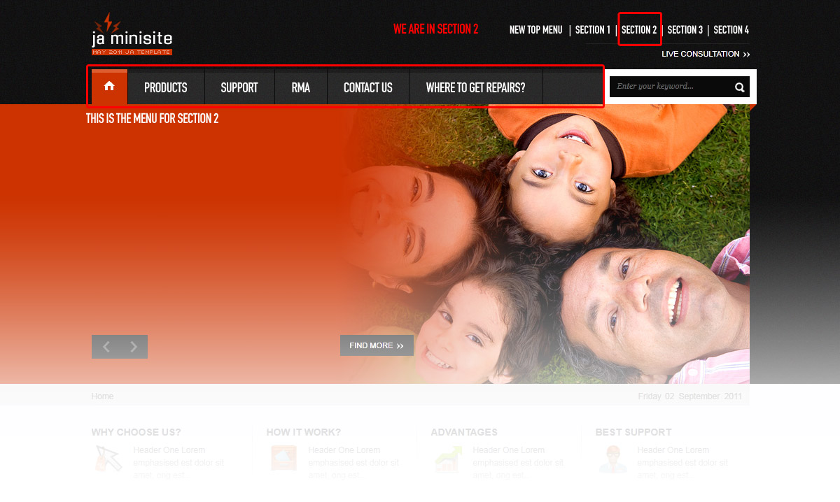

1. I make the top menu my new main menu. In this way, I have a small, discrete menu, at the top of the site, with my four main areas of the site. Each menu will lead me to a main area. Each area will have its unique template theme, set up on a different profile.
2. On the position of the original main menu, I put another menu, the specific menu for my area of the site.Here is an example of the intended architecture:
I’m not a programmer, so my questions are:
– How to I make the top menu become the mainmenu (the one Joomla cannot live without otherwise it will crash)
– How can I transform the original main menu position into a module position, so I can publish new menu modules to it, and taking full advantage of the template menu style?Each section will have its own theme and profile, but that I can do, no problem.
Here is an example of section 1
Here is an example of section 2
Here is an example of section 3
Here is an example of section 4

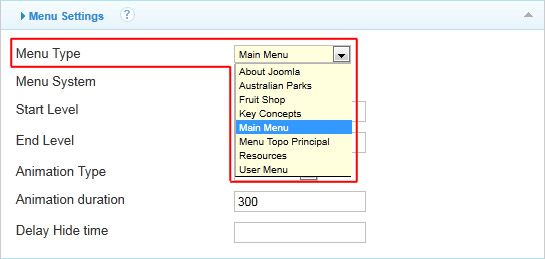

That is why I asked to move the “mainmenu” (including its definition as “mainmenu”) to the top position.Also, I would like to override this function (depicted below) on JA T3v2, as this seems to be the source of all language problems.
If JoomlArt could fix this function, making it work exactly as a module loader (a simple, by-the-book, system to load the stated menu in a module in the correct position, maybe including a locked (uneditable through the module manager) module on module manager), maybe the language problem would be gone.This override will allow me to disable this (menu loading) function on template manager, and load the menu as a module (including language settings) in the module manager.
I know I’m asking too many T3v2 modifications, but also I’m trying to improve T3v2 so the language woes are gone, and give more control to the user. Maybe a checkbox “disable” beside this setting, so the user can have the option to load menu as a module, would be the preferred action. We keep the power of simplicity of menu chosing on template manager, but we also give power users the choice to load menu as a module.
